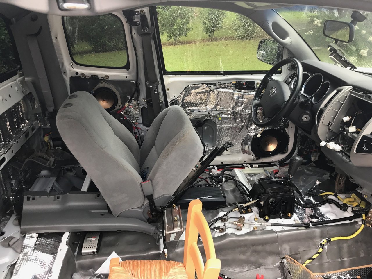

    I just finished my 07 Access Cab. Not the same truck, but will tell you what I did:
    Stripped all 4 stock speakers. Replaced all 4 with Polk DB6501s (6.5" components). The front door tweets do fit in if you simply cut the basket off the existing tweets. The rears I drilled a 3/8" hole just above seat belts to get the highs up high. I chose NOT to use any stock wiring, so I pulled all new speaker wiring (good 12 gauge 100% copper wire). It was tough getting through the doors, but worthwhile. (hint, if you take off one side of the sleeve (at the body), you can almost get a straight shot to use a coat hanger as a feed, tape wires to it and pull through).
    For the access cab sound deadening, I used 72 sf of the Noico 80 mil material. (2 orders).
    I did inside the doors (by cutting strips and reaching in through access holes), as well as the doors themselves. I also used this on the floor and every other areas I could reach. I topped off with the Noico 157 mil pad lining (which is a pad that goes on top of the silver stuff). 1 roll of that did all major areas, with a focus on the floor.
    For the amp, I bought/installed the Rockford Fosgate RX600X5, which has 5 channels (2 for front, 2 for rear, and 1 for sub). I had an old Infinity basslink which i used (has built in amp), so I am not using the 5th channel, which is made for a sub.... i expect to build a custom enclosure down the road and didnt want to buy another amp later on. I don't need BOOM, just a nice fill at the bottom.
    I know you do not plan on replacing the head unit, but I did. I installed the Pioneer NEX 4200. I did this since I wanted a rear view camera and good Apply Car Play setup.
    Everything is up and running and I am very happy so far. I also added HDMI, USB and 1/8" jacks on the center console.

    Pics attached. As mentioned, you can see the tweeter basket used. I misinformed you above, i didn't use the woofer baskets, i think i tried but ended up ordering from Amazon instead.

    my truck would look like a rolling wreck for ever after if I tried that... ;)

    Agreed.. I'll take some "after" pics soon and post them up. It was about 40 hours in tearing apart and putting in sound materials. 6 hours or so in wiring/installing. Good times... I have learned through many of these types of projects to put screws back in after taking stuff out (to remember where they go) and keep moving, if you walk away for too long, you lose interest and end up with a hot mess that turns into an ugly incomplete project. It's pretty buttoned up now though....
