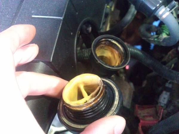

    what is this?
    I'm doing an oil change and saw this white/yellow ish grease type stuff,anyone?

    Moisture, do you take alot of short trips?

    ya bout 70%

    a lot of short trips that don't let your motor get up to running temp I believe.

    I think I read that these trucks get moisture in the fill caps
    Hate being the bearer of possible bad news but... that could possibly be coolant in your oil which means a probable head gasket.
    Has the truck ever overheated or been in extremely cold weather with old/bad coolant?
    take a good look at your coolant, see if there is oil floating on top.
    Just clean all the white stuff off, change the oil, change the coolant, and keep a close eye on things.

    follow the like he provided, just moisture from short trips.

    Yeah, I just read the link, that's the one I saw before! Helpful for sure
    My truck doesn't have this condensation, although I only have 3,xxx miles on mine. Does this happen to almost off of the 2nd gens?

    Let me guess, cold and short stop and go's? That will do it. If it was a head gasket, you WILL know!

    Alot of dodge's do it.

    That's what mine looked like the last time I changed my oil. I'm glad I had heard about the moisture problem before or else I would have really freaked out.
