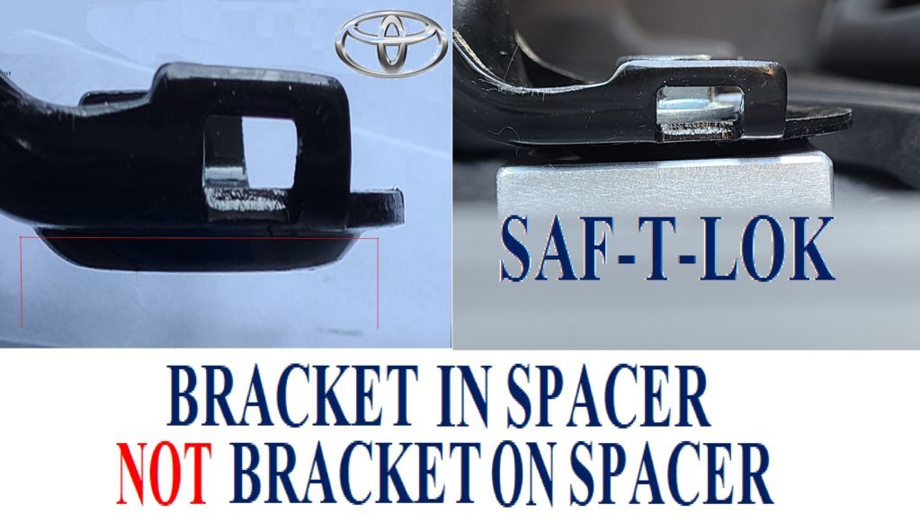

    Does Toyota still use the same m10-1.25 bolts. Are the undersides of the brackets flat or do they still have a round shaped boss. My rear spacers are made with different pocket shapes, flat top or round pocket or rectangular pocket, so the brackets rest in the spacer instead of on top of the spacer. Typical pre-2024 spacer with pocket shown:

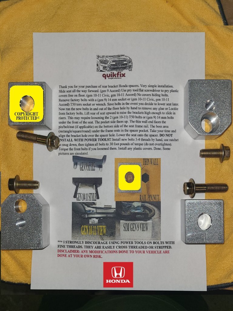

    1st thing is, at this time, I am not currently looking to make them for the front brackets. I am currently addressing the needs of lifting the rear of the front seats. I sold over 5,000 sets of rears for the FJ Cruiser and 2nd/3rd gen Tacoma. Probably $33-$35 for 1 seat and $56-$58 for 2 seats. Will include bolts, instructions and free shipping. Depends on a couple of things. Current design or new design, shipping costs, machining times, etc. I can guarantee they will be better fitting, fully custom machined and hand polished grade 6061, and much better and cheaper than anything the "desert' guy will provide. I may address the front brackets later. For reference the front and rear kits (pictured) for the Honda vehicles are $88 per seat which is cheaper than the "desert" brand front spacer kits.
    I have detailed pictures of ~70 vehicles however I cannot find any pictures or schematics for the 2024 Tacoma floor brackets. Initially I may provide a discounted test set to the 1st buyer to see if they work ok or if I need to make any design changes. I am big on safety and really hope to make them with a pocket. The pocket insures that the bracket will not shift, or slide off the spacer, in the event of an accident or sheared bolt. With body weight on the seat, without a bolt installed, you cannot knock the spacer out with a hammer.

    Yes, the bolts are M10 - 1.25. I did not notice any boss or pocket. It was a while ago, but the mounting surface for both front and back brackets of the front seats were flat pads. I used hardwood plugs from a hole saw as spacers.
