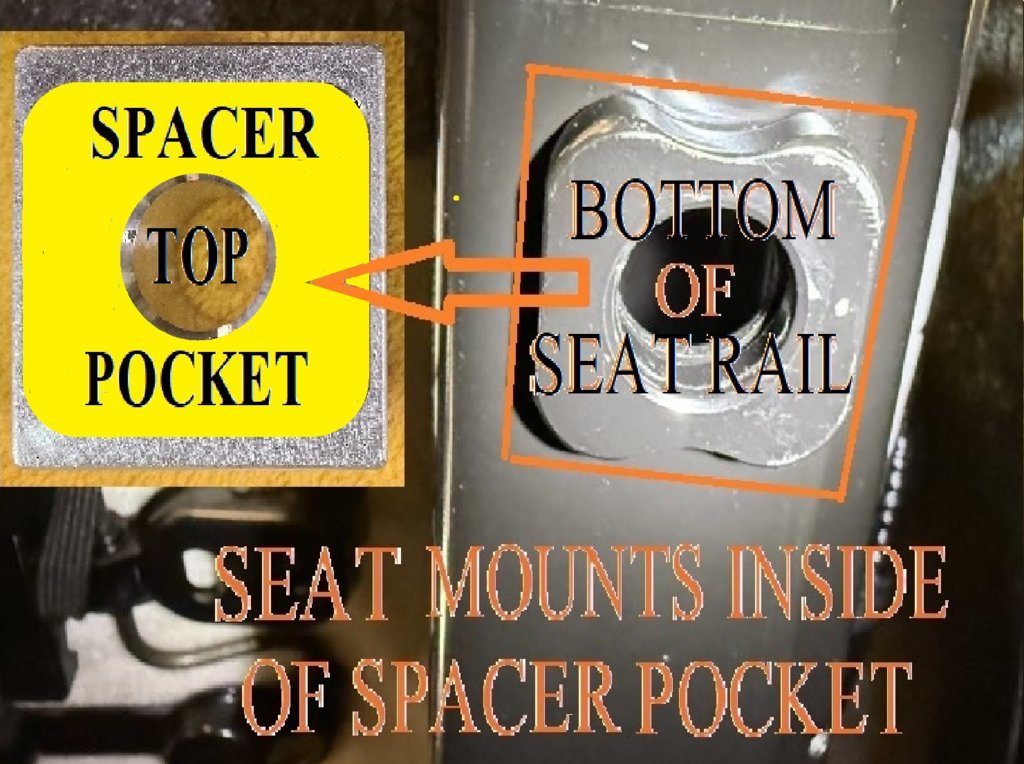

    I have found that my rear bracket Honda spacers appear to be the identical pocket shape that is required for the gen 4 Tacoma. I will be sending some out for fitment by the end of the month. These will still provide bracket in spacer, instead of traditional bracket on top of a flat spacer, which is the safest spacer to use. I tested this with early designs and, with someone sitting in the seat without the bolts installed, you cannot knock the spacer out with a hammer. I call it my SAF-T-LOK design and no other spacer manufacturer makes them like this.

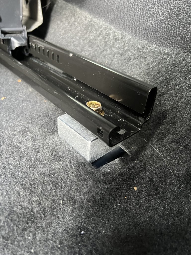

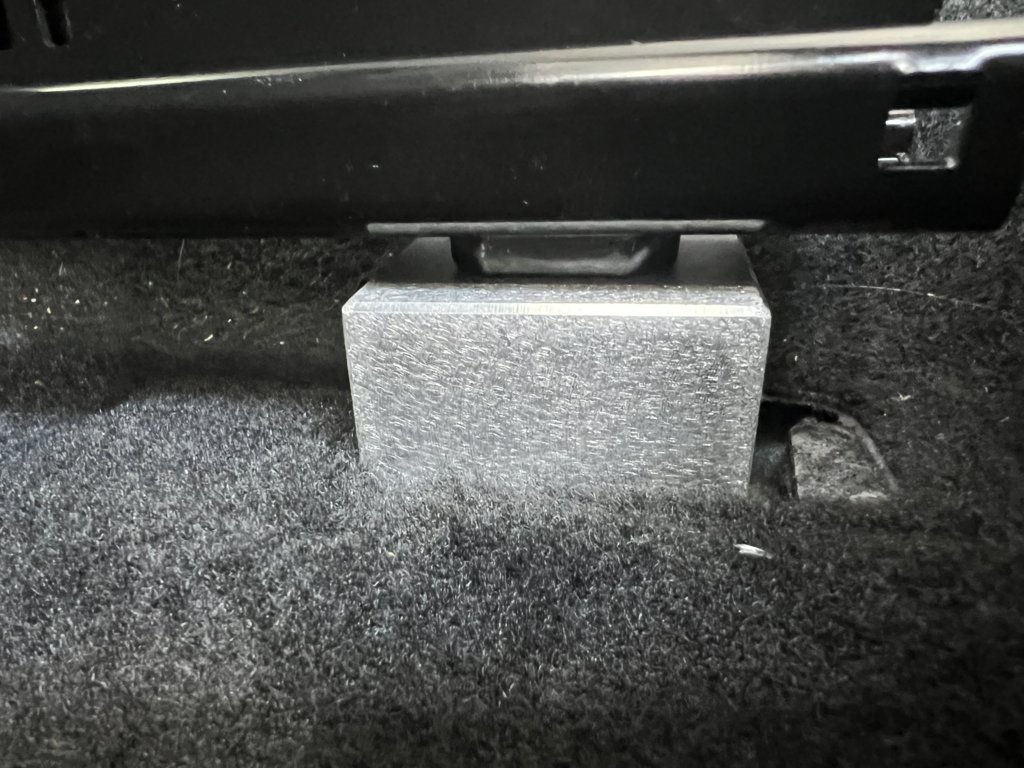

    Just an update: 2 sales of new style rear spacers, both happy with comfort, pocket faces down onto mounting hump in floor, flat side up. Not as I intended however they are stable. Mounting floor humps under bracket would not work with flat washer style spacers sold elsewhere. 1 customer now wants 2nd set for passenger seat. 1 customer still on the fence. Neither has returned them for a refund.

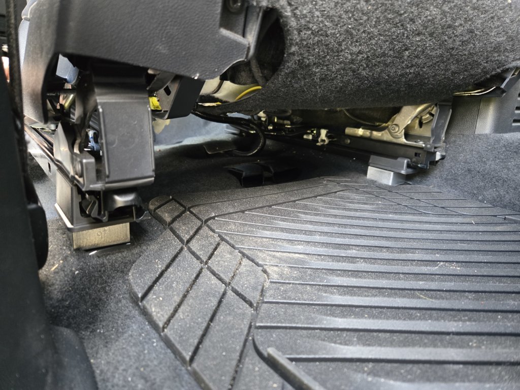

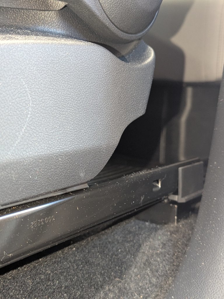

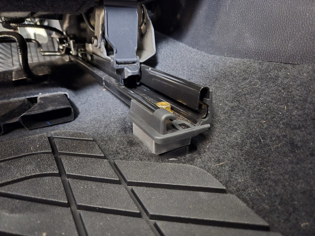

    Installed pictures. Unpainted mounted with pocket down on floor hump. Black painted by customer and the pocket is facing up as planned.:

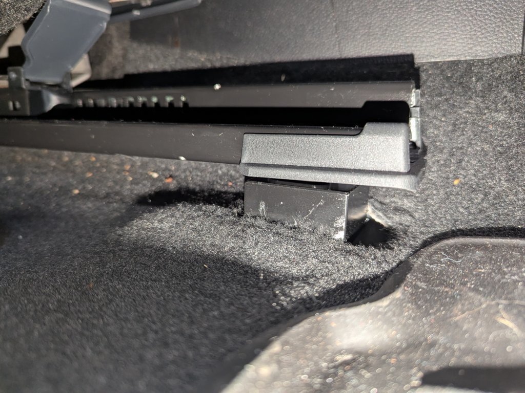

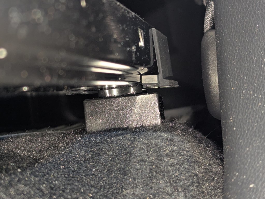

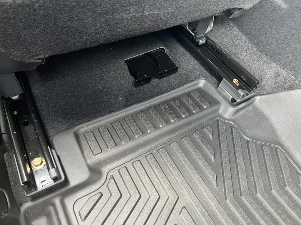

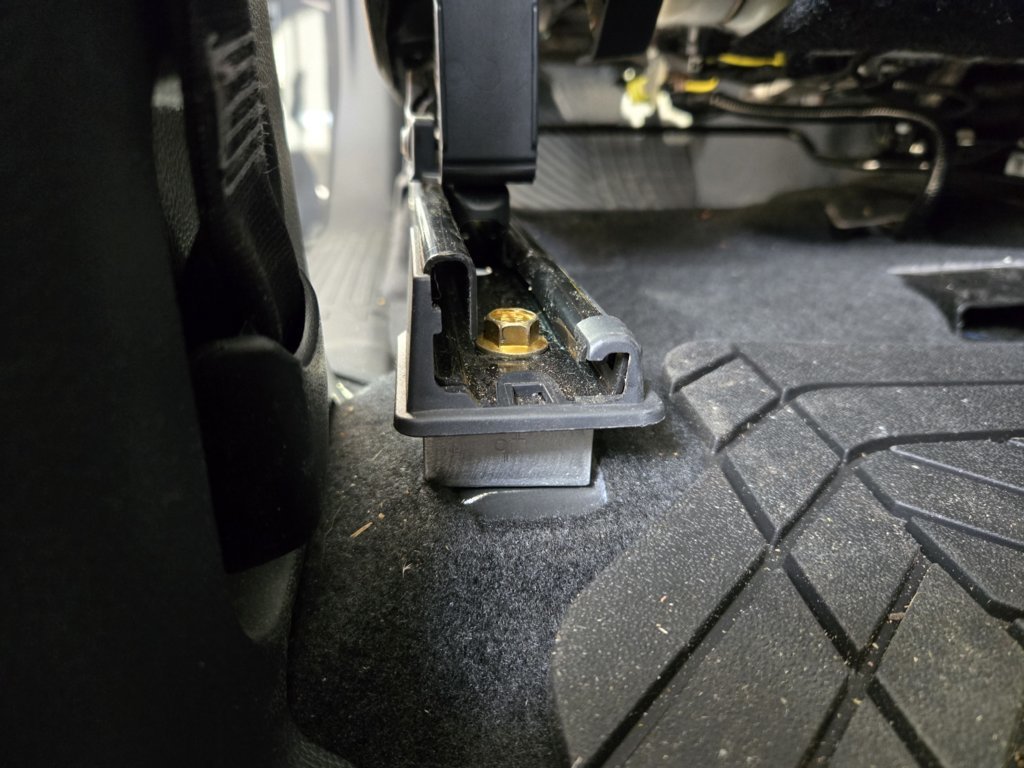

    I now have 5 sets of the spacers out for reviews. So far the reviews are positive. Only 1 person mounted his 'upside down' to get what he considered to be a better fit. A couple have stated that their truck did not have a 'hump' to deal with on the floor. One was a 2024 and one was a 2025. Not sure if there was a change to the floor or that the initial 'hump' picture was exaggerated by the camera view. It appears that the current shape, with the newest mod, seems to be functional and safe. Once I receive more input, after at least a solid week of use by all 5, I will make any requested changes and add these to my next production run. I will then post an ad in the 4th gen classifieds. Any future sales would be $40 for 1 seat and $70 for 2 seats. This is the same price I charged from 2019 to 2023. For the past 2 years materials have increased in price and shipping has increased in price. There has been a 20% increase in aluminum in 2025. Now tariffs are going to add more cost to manufacture. For reference I am still much cheaper and better quality than my competitor that makes extremely cheap thick washers and charges $15 more per pair for rear spacers.
    Most recent installation:20250411_174326.jpg 20250411_174342.jpg 20250411_172538.jpg

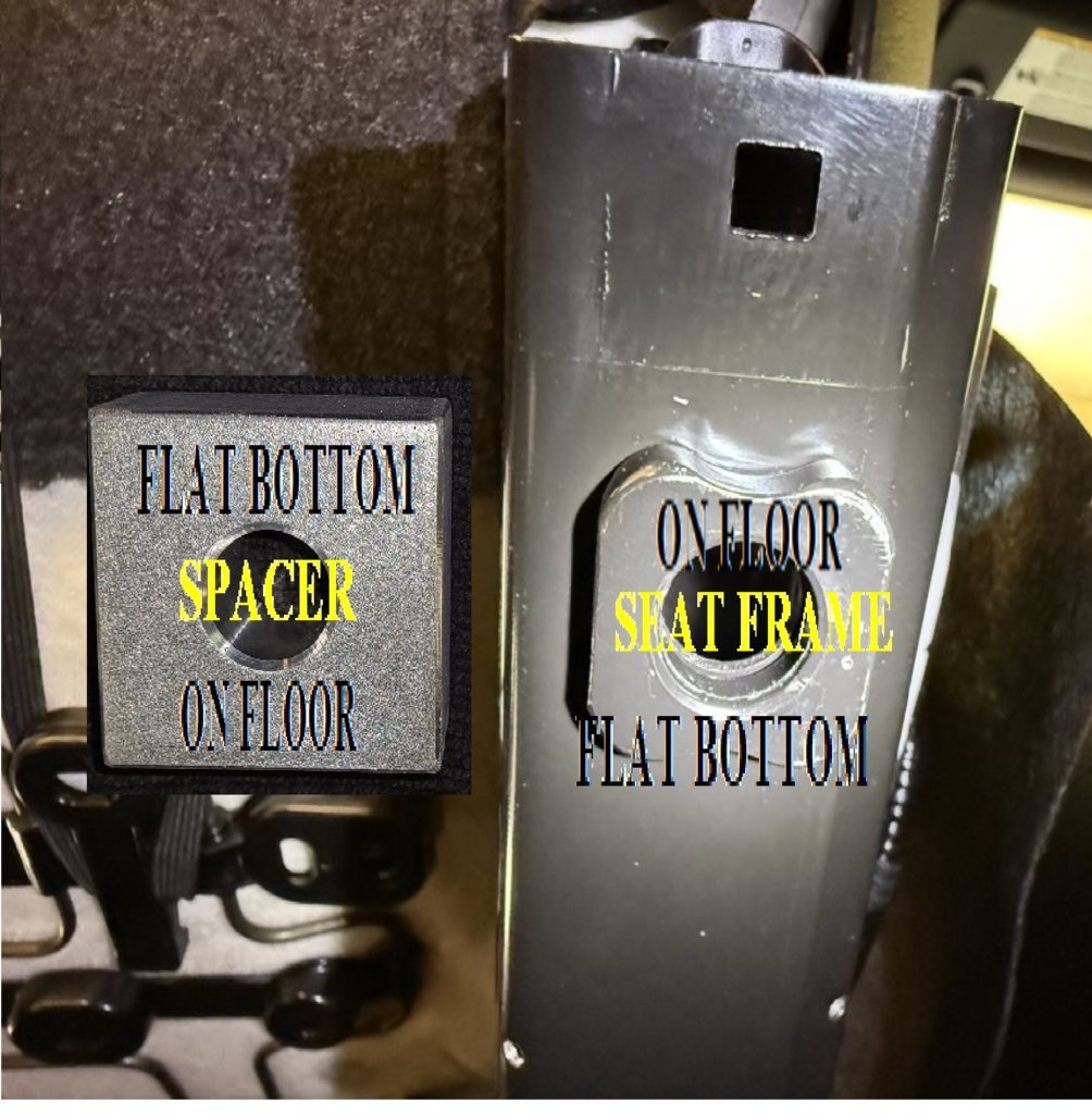

    So far my rear bracket, front seat, 4th gen spacers (seat leveler) are mounted in, or enroute for installation, to 8 total people. So far mounting in 2024 and 2025 SR5, Sport and Off Road models, with both automatic and manual transmissions. To my knowledge all are non-hybrid vehicles. Not sure if the hybrid will require a different shape of spacers. Here is what I know so far.
    (1) The mounting area of the seat frame, the area under the frame where the bolt passes through, is completely flat just like the bottom of my spacers have always been. The dimensions of that flat seat frame area will indeed fit within the pocket machined in the spacers.
    (2) The aforementioned floor mounting surface, regarded as a "hump'', is an odd shape however the spacer is virtually identically flat on the bottom as the actual frame mount of the seat. I made a mod on the bottom of some recent spacers however that mod is not required and will be discontinued.
    (3) I have received all positive feedback with regards to comfort. Only the 1st person mounted his with the pocket down. All others have mounted them as designed with the pocket up directly against the seat frame mounting point. Otherwise I have had no complaints with the fit and installation.
