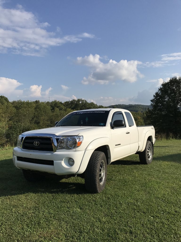

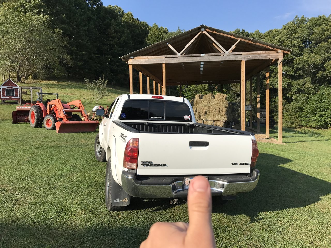

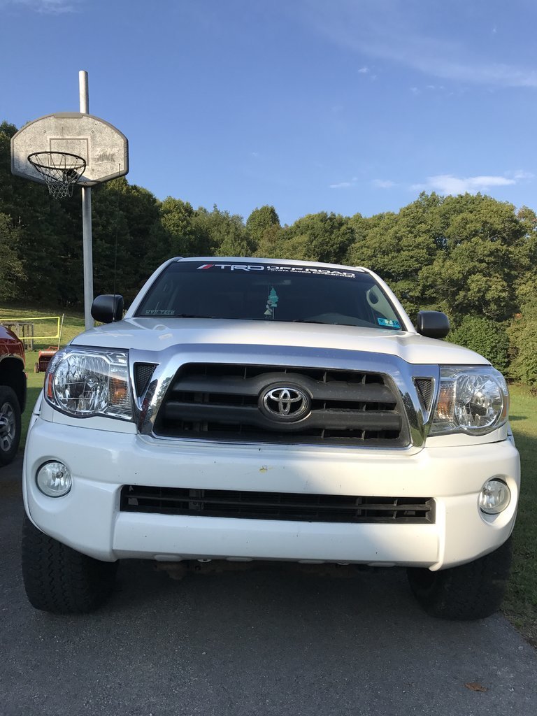

    So, I've had an idea that I've seen multiple videos on. I have thought about plasti dipping my front grille & rear bumper to get rid of the chrome.
    I don't have a problem with doing my bumper, but the grille makes me a little nervous & I was wanting some honest opinions.
    I've been thinking of how the grille would look if I covered the chrome, as well as go over the black & chrome Toyota emblem. I'm eventually going to have a grille super white grill with black mesh made by @HomerTaco but until then I'd like to get rid of that chrome somehow.
    So what do you guys think?

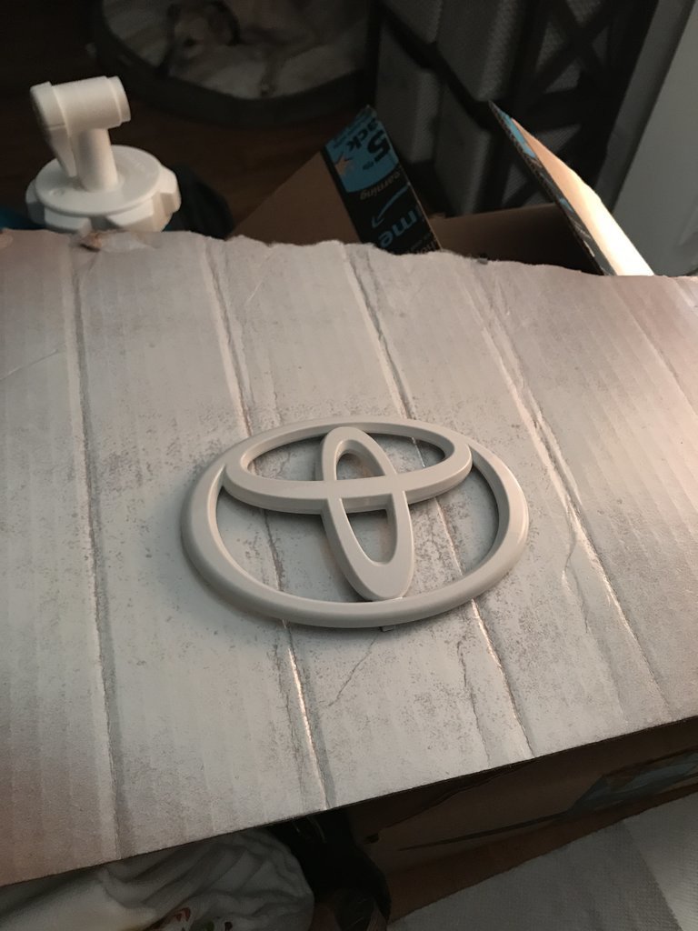

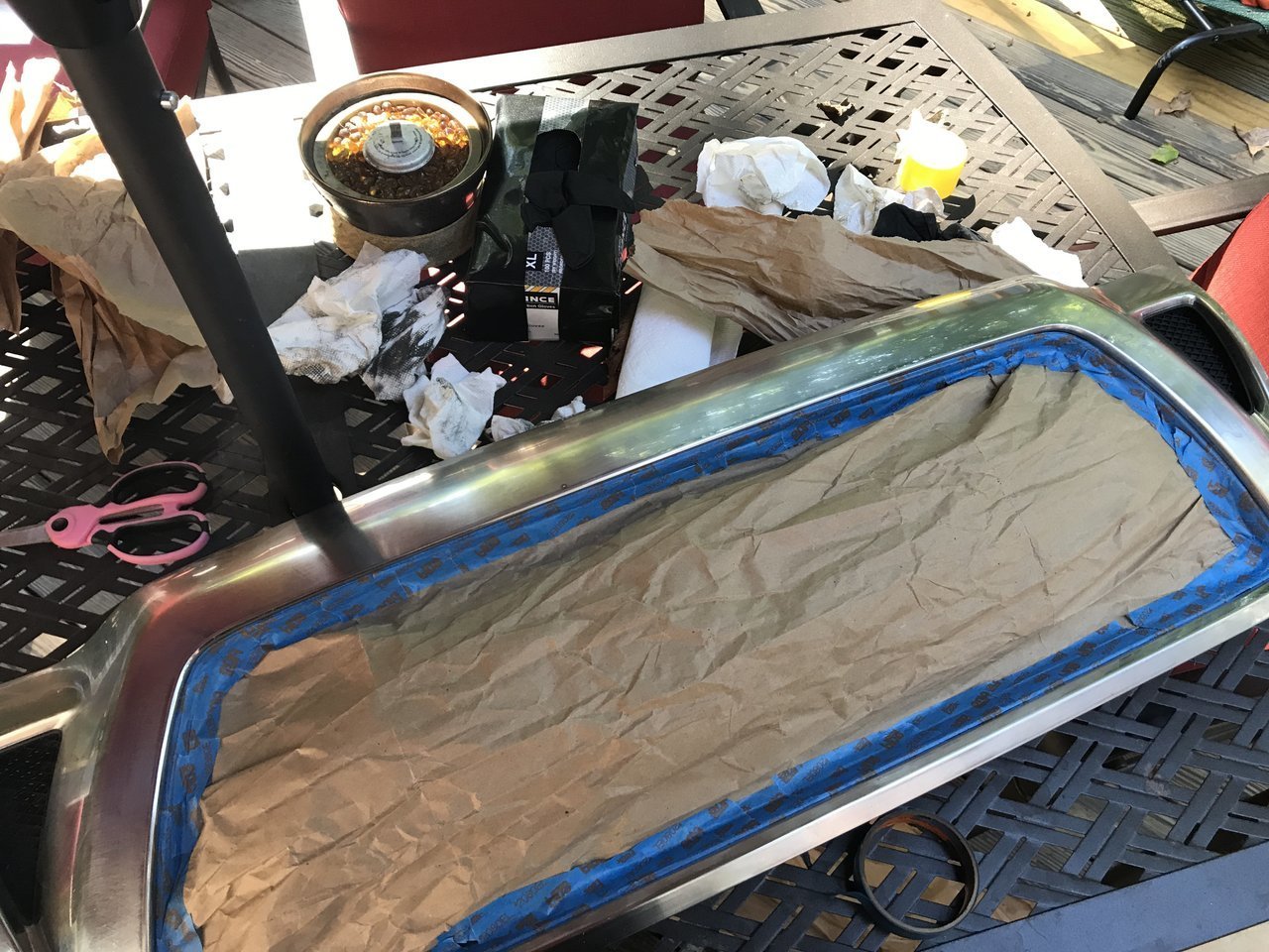

    I haven't put it back on the truck yet because I'm letting it cure for a few more days in my living room, but here it is. The toyota symbol is also now white and drying separate.

    Ah! That looks so good man. Do mind if I ask about how much you paid for paint? I'm sure it wasn't too bad for just that little bit

    I bought 150 grit sandpaper, a can of adhesion promoter for ~7$, a primer/paint combo for 5$ and a can of clear for 5$.
    Didn't buy color matched paint. The white on these trucks is so hard to match that it's not worth paying the extra. Also the "problems" you speak of are avoidable if you do the proper prep work and let it cure for 3-4 days. worst case scenario it doesn't hold up, and you have to spend $9 for a can of derp to cover it up. Seems like a no brainer.

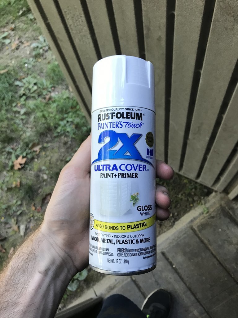

    This is the paint I used. I have yet to mount the grille back on the truck, so I can't comment on how close of a match it is. Looking at my grille, it looks like it'll be a good match. Either way closer than plastidip.
