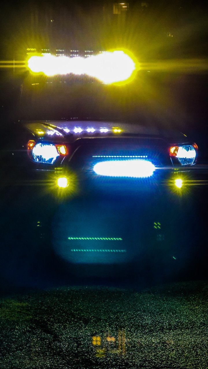

    Hello!
    2015 4.0L 4wd SR5
    I installed 35W Auxbeam foglights and have unknown LED headlight bulbs installed. After about a year, I'm having problems.
    My lights are dim and the right side often fails to power on. What I thought was a burned out light isn't, because it comes back on after I cycle the lights on/off or hi/low beam. One of the guys who works for me told me it sounded like the harness was going bad.
    Since then, I've realized that the Tacoma factory lights were 50W and that the harness is insufficient even for the factory wattage.
    What harness should I buy to upgrade from the 50W standard capacity to 100W or better?
    Thanks for any help!
