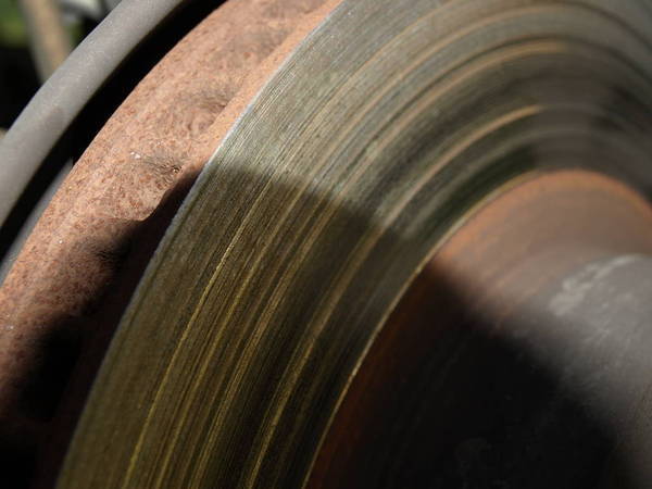

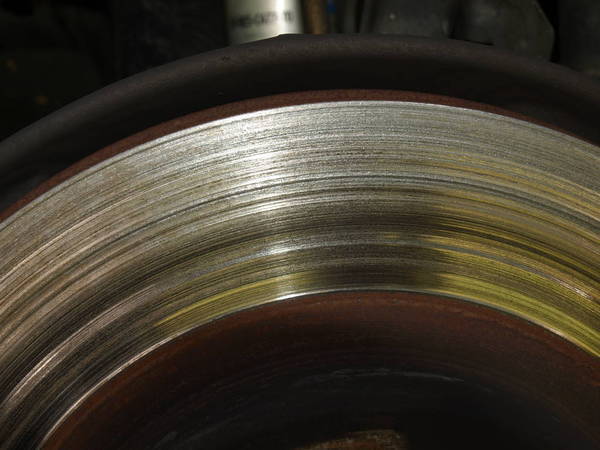

    so my drivers side front wheel has been making a strange noise like metal rubbing against metal and it was bugging me so i took the wheel off and my rotor has all these grooves in it anybody know what is causing this

    Dirty or worn out pads are my guess.
    all in all it doesn't look that bad judging by the pictures.

    yeah the pictures dont look that bad but when compared to my passenger side it is really bad and my brake pads are at about 50%

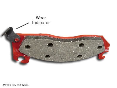

    Take a look at you wear indicator on your brake pad. If they are really bad it is possible the indicator is touching with out brakes applied.
    The best way to troubleshoot this would be to jack up the front end and remove the wheel, spin the rotor and see if you can duplicate the problem. If so remove the pad and give it another spin. If the noise still persist I would go for the bearing.
    Our wear indicators look a little bit different but, this should give you an idea.
