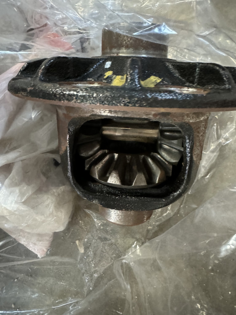

    the carrier for 3.73 doesn't work for 4.56. you either need a toyota carrier or arb or some kind of locker. the part number for the toyota one is
    For front gears clamshell T8S
    Differential Carrier Toy41311-35120

    Just went through this myself with 4.30 gears. The above info is correct. You need the 41311-35120 carrier to run 4.56 gears. ECGS will get you squared away without any drama. I'm another happy customer and have found they usually are pennies on the dollar compared with local shops who generally don't know what they're doing.

    I ended up returning the standard size 4.56 and bought a "Thick" 4.56 ring which works with the 3.73 carrier. Was this a bad call? Should I have bought a different carrier? He only charged me $250 to regear and install new bearings and seals. I don't think it was a bad price but I'll def be taking my business to ECGS for any further diff work. Thanks for your help fellers.
