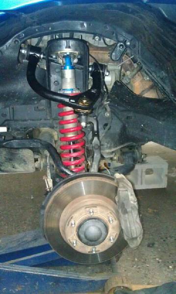

    i have skyjacker 3in coilovers , fatbobs 2in spacer an lr ucas ! had to get a shop to fabricate the adjusters just to get it in allignment an now when i go into turns fast or go over bumps that let the weight lift up off the front it feels like im driving on the rumble strip times a million! i also ripd both cv boots an i have the diff drop in! ... im know i have everything pretty maxed out but what the hells going on ! :(

    Post some pics of your setup :popcorn:

    Yeah, lemme see those half shafts :popcorn:

    I'll post some pics today gota jack the front up at lunch break !!

    no i have stands!! my other jack is a lil guy thats why im not using it lol

    i got a picture of my front end setup in my gallery !
