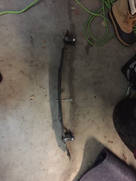

    Trying to install my all pro 3-leaf add a leaf. Few questions:
    1. I noticed the center pin is off set. One side of the leaf set is longer than the other from the center bolt, should the longer side point towards the rear or front.
    2. Center bolt and bump stop. The new center bolt is longer to accommodate the extra leafs, but the over all bolt length is almost taller than the whole stock leaf bump stop? OEM center bold is not long enough.

    Solved my #2 question, apparently the longer bolt aids in putting the leafs together and is intended to be cut short after.
    Still curious about #1

    Longer side towards the rear.
