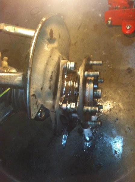

    I will post pics of what you need to remove. Just replaced my hub and axle.
  18. Dec 2, 2013 at 8:39 PM
    #18
    Jakers83
    Jakers83 Well-Known Member
    May 13, 2013
    #104106
    265
    Jake
    Denver
    2.7 base.
    OME lift. Tires and wanting more
    This is with the rotor off. Just get a punch, press or bolt and hammer out the broken stud

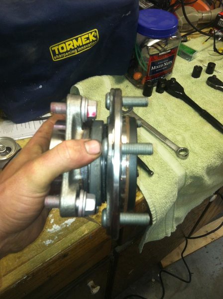

    New hub and studs that you just need to knock out
