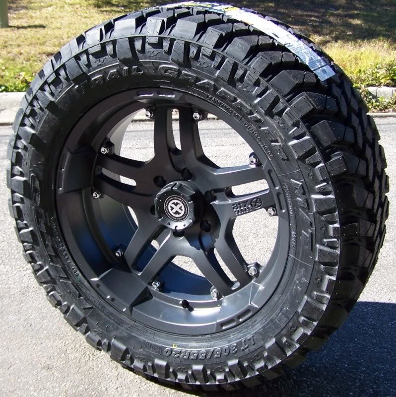

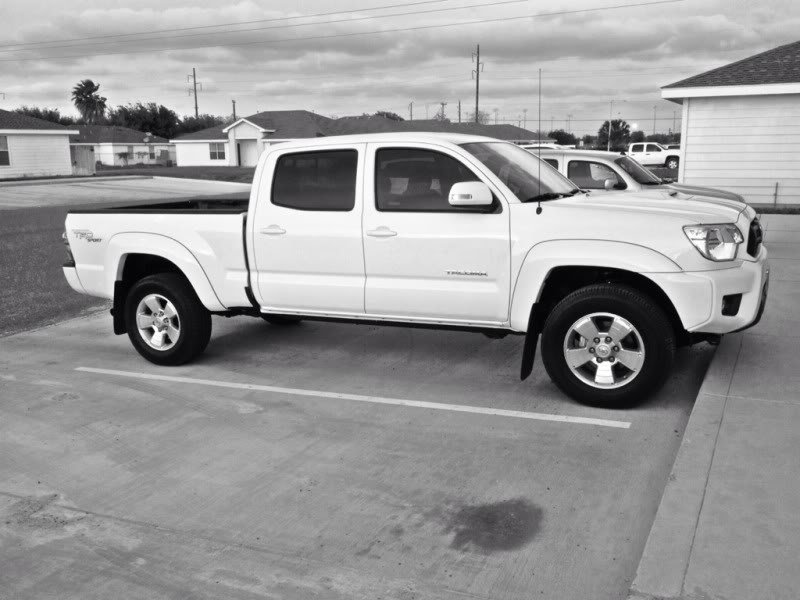

    Just bought my 2012 DCLB TRD Sport 4x4 today...gonna lift it tomorrow...will probably get the RevTek 3"...is that an ok lift? $700 installed? I could never install anything by myself so paying someone else is my only option. Also....tire size? Rim size? 285 or 33's? Will they rub? Will I need to cut? I didnt find many examples to look at on the build threads. I need help baaaaaaaad...and quick...I'd really appreciate it. I'm new to the Tacoma World in general. Thanks in advance. Here's my truck and the wheel/tire I'm getting installed...

    first of all congrats on the new wheels :D and welcome. You are going to rub and yes you are going to have to cut back some fender. YOu dont waste anytime lifting your truck, just be advised that some dealership i mean stealership wont accept warrenty work on a lift truck which is gay. Did you get the Add a leaf with the lift?? the wheel size you might want to look for 285/70/17.

    Also, you're wheel and tire combo is good. The 285 will def rub if you don't do some trimming of the inner fender liner and chop the cab mount (they're bigger than they need to be anyways). Make sure you have enough back spacing to clear the Upper control arm and you'll be good to go.

    Edit: is that the actual wheel and tire you have right now didnt see that they were 305's you will have to cab mount chop for sure and trim your fender like crazy

    I'll definitely order all these items instead...and that pic is not the actual tire sz I'm getting...shooting for 285-75-18...sound about right?

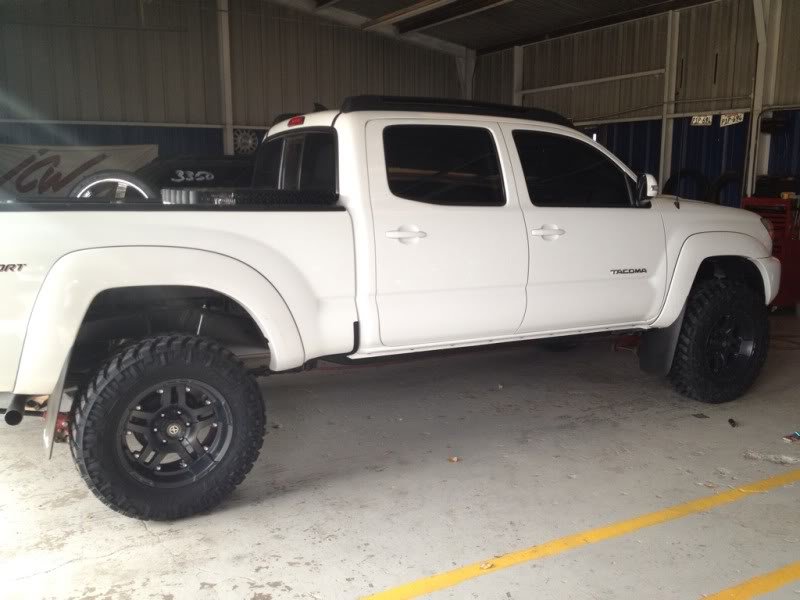

  18. Mar 20, 2012 at 9:24 PM

    this isnt true.... new law states that the dealership has to prove that the aftermarket part you had placed on the vehicle is or was the main cause or a contributing factor of the damage..

    Nice looking truck

    Well done OP. The SuperWhite taco with those rims looks good.
    Which lift did you go with?
