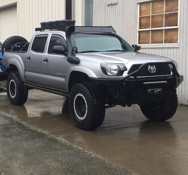

    Well I finally got it figured out and the truck put back together.
    Turned out to be the crush washer in the front diff was installed incorrectly and was seated crooked. That caused everything else to be crooked and in turn caused a bad vibe. Go figure. I sent the front and rear diff to ECGS and they went through and replaced everything that was messed up because of bad install(not by me). They said they never use a crush washer and replace with a solid spacer from the start. Cant say enough good things about them, highly recommend. Lesson learned, just buy new :cool:
    Truck runs great. Smoother than ever. Since it was immobile for a couple weeks, I was able to get some other things done. With the help of some good buddies we also installed a snorkel and fitted for 35s along with some other stuff. Can't thank them enough!!:hattip:
