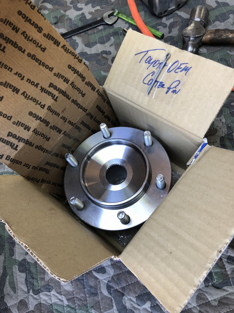

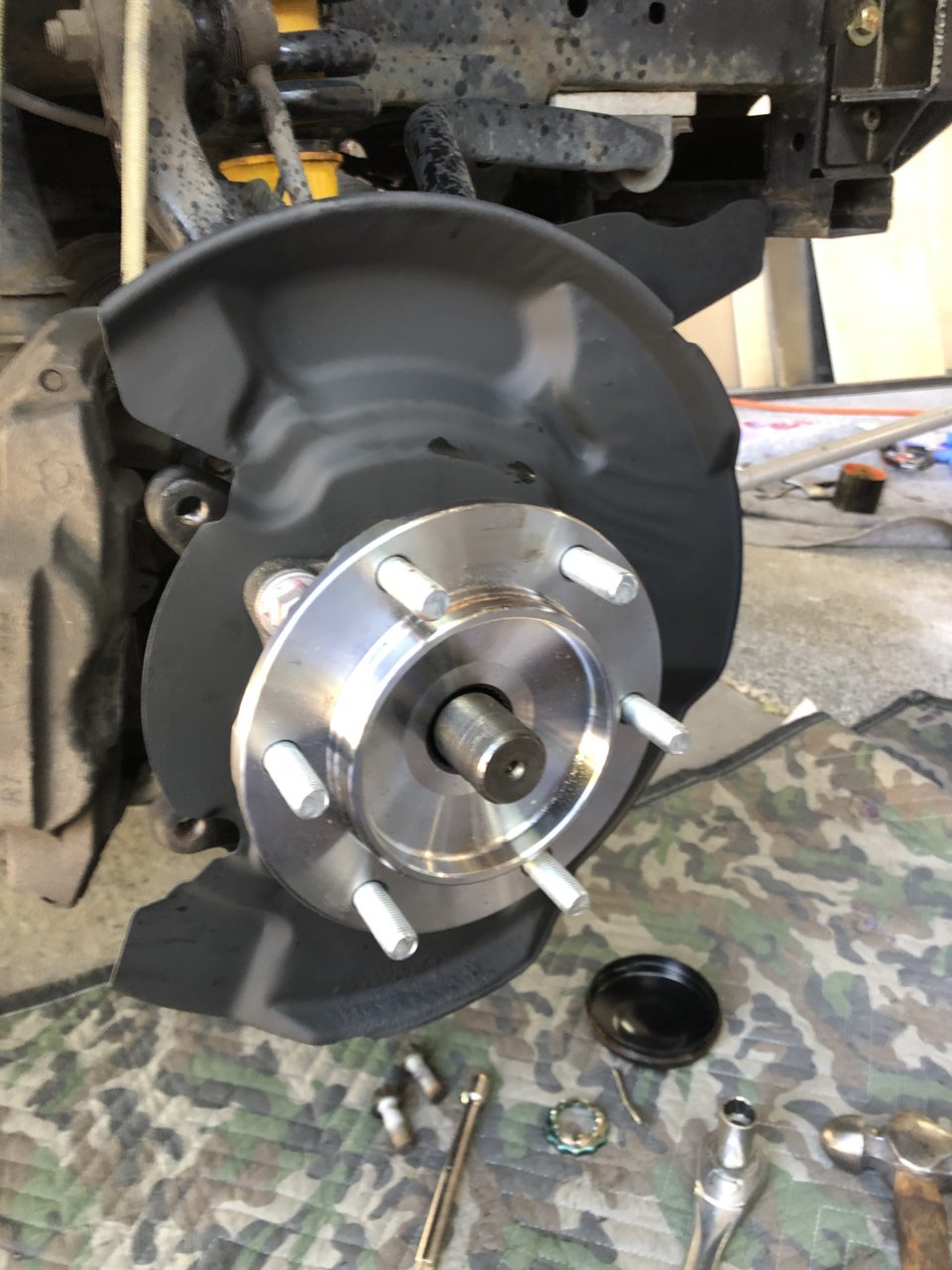

    I just did this and ordered Blue pit bearings and it was a super easy job, 1 hr tops per side and that included cleaning up the wheel wells. $500 for the bearing and hub combo, totally worth the price, and Andy will send you new OEM cotter pins for the Axle nuts
