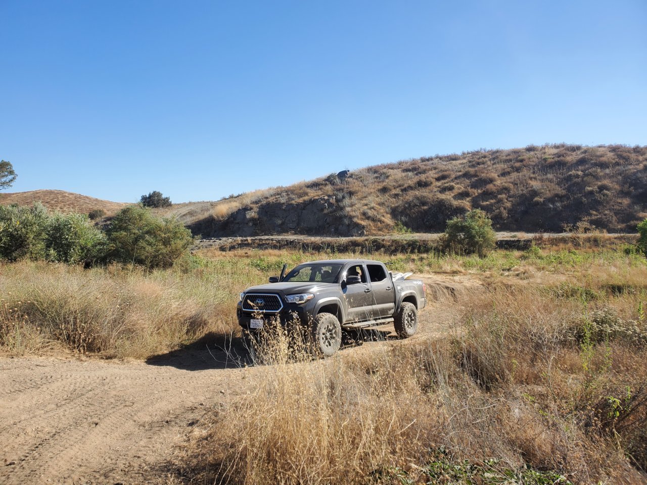

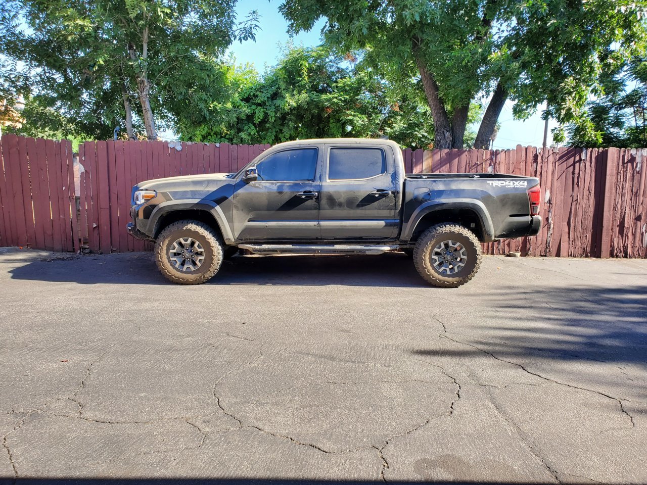

    I had it on for about a year, drove really good. No problems with them. I had 285 75 16. I upgraded to coil overs and new leaf springs and went with 315 75 16s... The 5100s are just as good as my coil overs.
