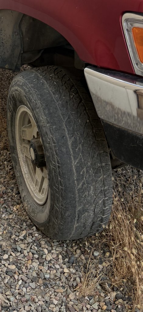

    So clutch and head gasket need done before I take it out again. The other thing I noted was a slight grinding noise when driving which the guy I bought it from said it had a suspension issue but unsure what. He said he put a two inch lift on the 4Runner and has noticed it since. You can see in the tires that is wearing heavily on the outside of the tires. The guy thought maybe increase the size of the tires would solve the issue but was unsure and didn’t have the money or time to figure it out. I’m thinking maybe that or he never did an alignment after which is why it was wearing the tire like that. No idea on the grinding sound but makes since to my dumb brain.

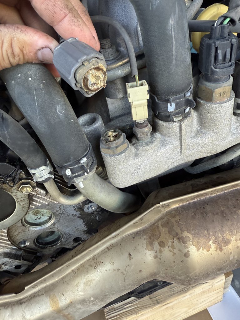

    I don’t have a great view of the heads and the block but the coolant looks like it was running down the block and running off right between where the engine and the transmission meet. It doesn’t look like it’s coming from the radiator and the heater core looks fine. Maybe a water pump but thinking more toward head gasket. I could do a pressure test to confirm but the 3vzfe engine is freaking stupid and not user friendly with spark plug location on the passenger side. All the spark plug have a slight tilt into the engine and most of the plugs require some knuckle or combo of socket extension to get the plugs in just right.

    Your call. Personally I’d pressure test and confirm the leak site before tearing into it because:
    1) It would suck to do the heads and still have the coolant leak afterwards.
    2) Something else might break when you’re pulling the heads, you could end up with new problems, and you won’t know for sure if you addressed the original issue.
    Let us know how it turns out.

    Could just be a coolant hose?
