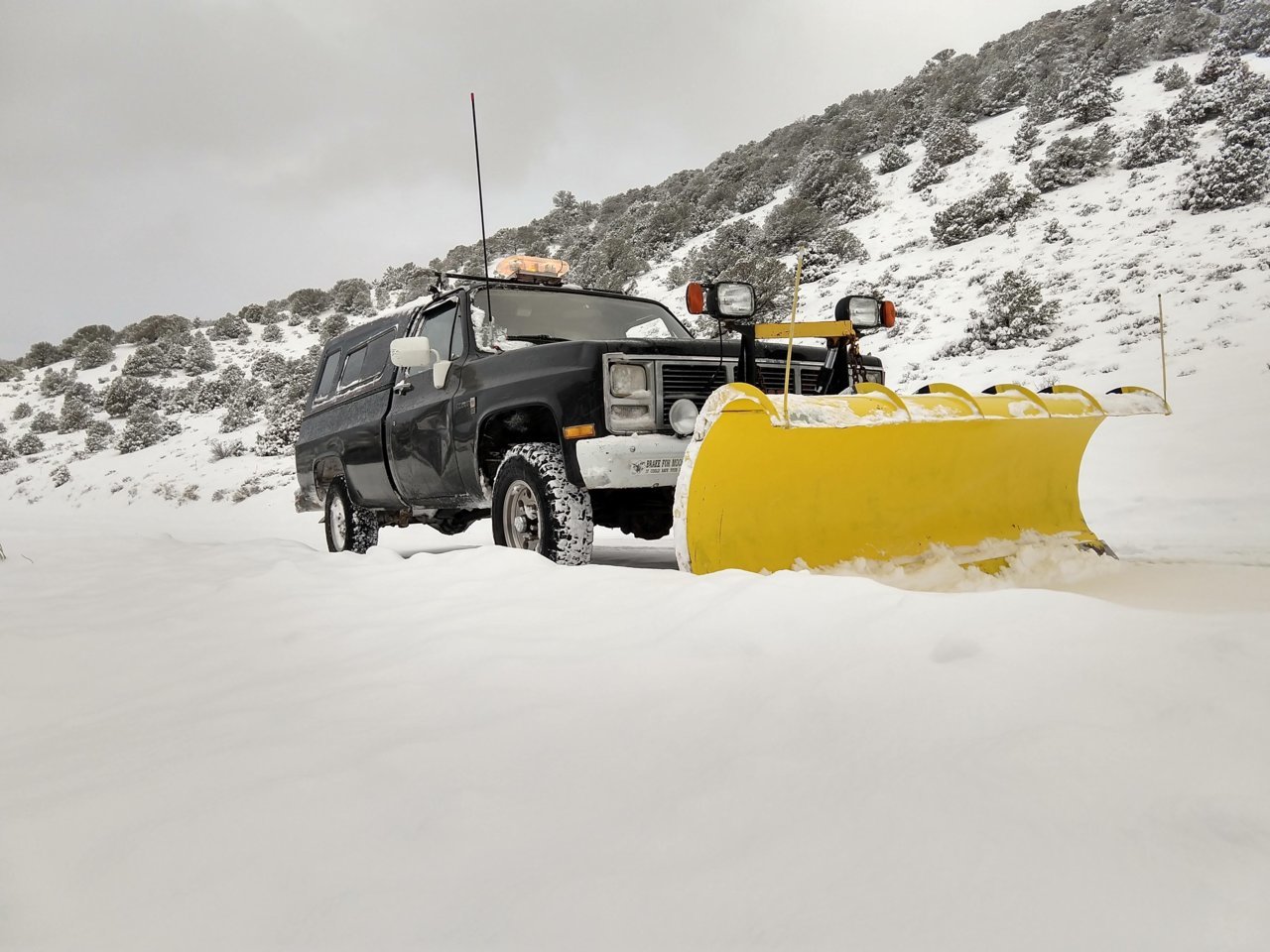

    I run 235/85/16 on my 6800lbs without the plow GMC K3500srw OBS plow truck at 40psi.
