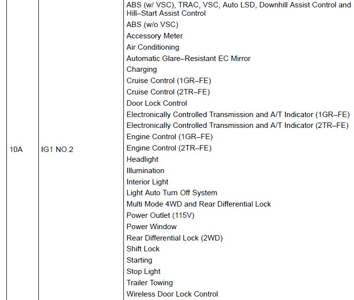

    You stated that the 10A IG1 No.2 was not "hot" when you metered it. Where there any conditions for the vehicle to have juice, like key in ACC position and by any chance it blew while checking?

    This fuse relation is specific to a 2005, I don't have the details for your year.

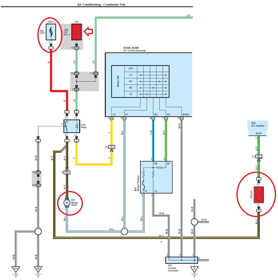

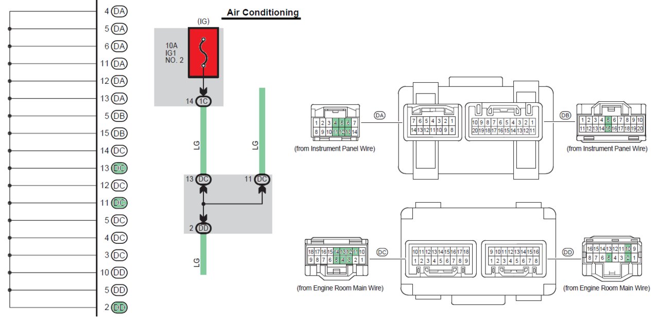

    When the fuse blew for the IGN no2 the TCS lights were on an the windows didnt work. replaced the fuse and those controls worked again.
    As of right now, the only thing that does not not work is the interior fan. I would bet money that jumper wire they are running as a band-aid is contributing to the fan not working.

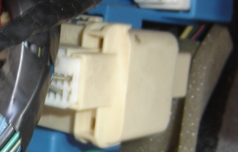

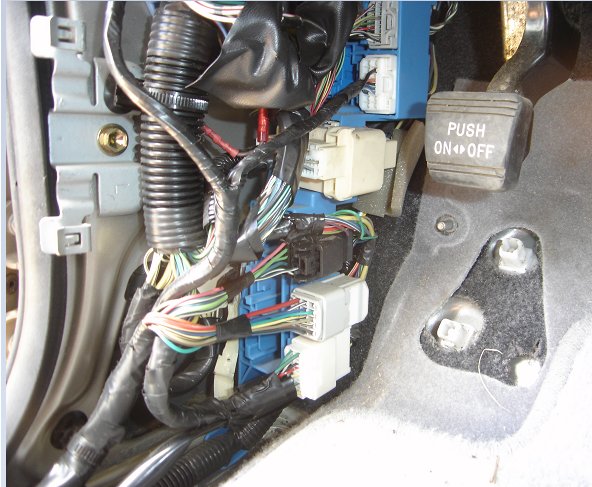

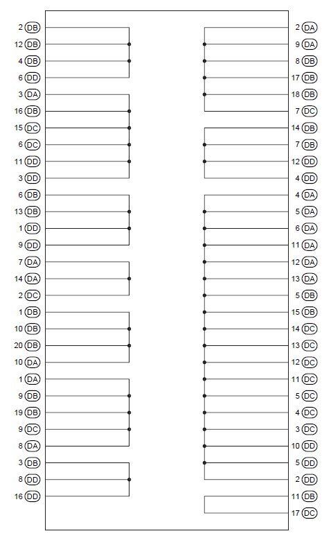

    Junction Box that ties the 10A IG1 No.2 to all its related circuits...
    Drivers Kick Panel towards the firewall low

    That junction box looks visually ok, ALOT of wires going back in forth in that unit. Going deeper tomorrow, hopefully I will find something

    All junctions/ties in both sets...one box, 4 connectors.

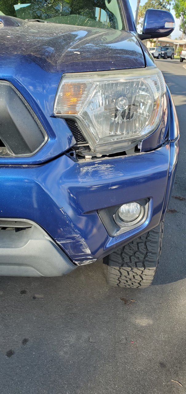

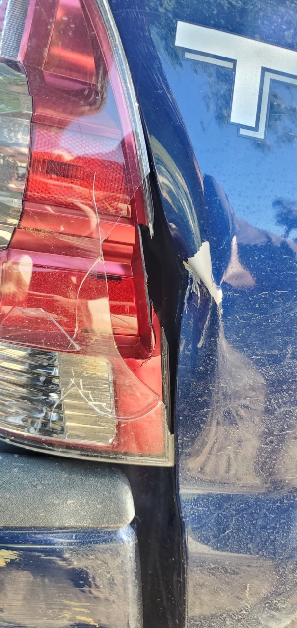

    UPDATE... sorry I have not been on here, my truck got hit in a parking lot‍♂️ and has some substantial damage so it's going to the shop soon. I dont want to start taking panels off until the truck gets repaired...
