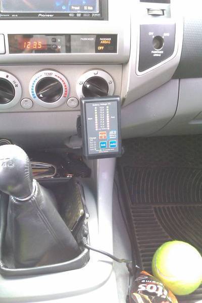

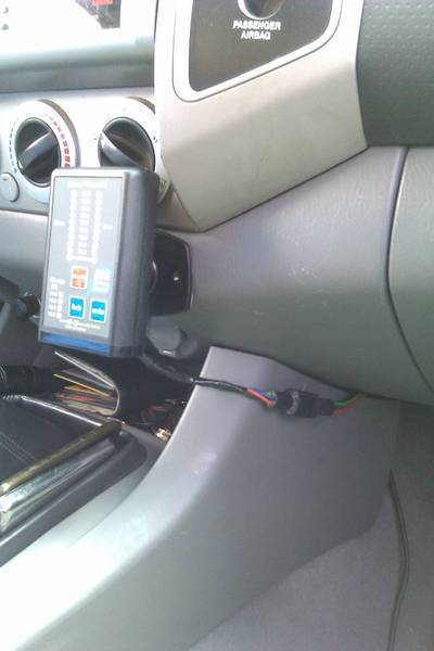

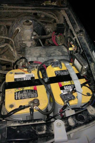

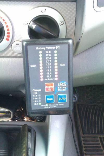

    i dont know if you wanna buy something like this but this is the setup i have in my truck:
    two yellow tops and an IBS-DBS dual battery system.
    the system controls when to link or unlink the two batteries, you can also manual link or unlink them at anytime. In the auto position, the system links both batteries while the truck is running so that they both fully charge, as soon as you turn the truck off it unlinks them and runs your secondary battery only. And then of coarse you can link them back together manually if you like. I love the system. Got it from SierraExpeditions

    the setup i have does all that too and more!! You can switch from manual or auto also
