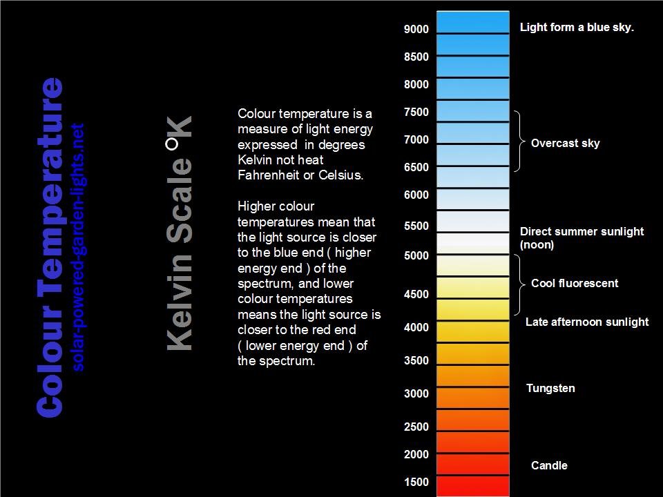

    Another note ..
    The higher the number like 8000K wont mean its brighter. The "K" is referring to Kelvin scale. Color/temperature.
    The blue bulbs are actually dimmer and terrible in rain, dust, snow, and fog.
    Try and stick to 4300K to 6000k

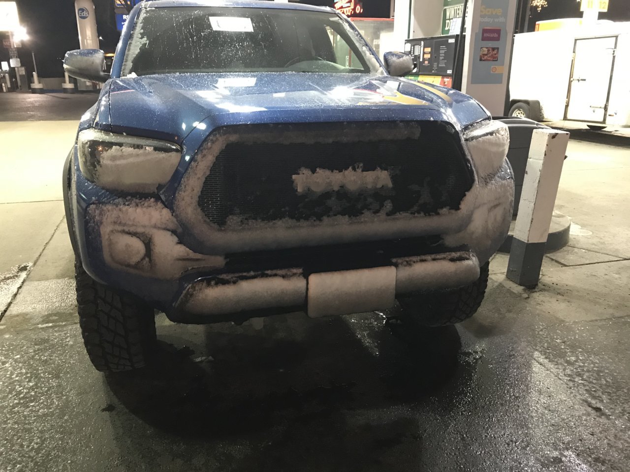

    On top of what’s already been stated, the lack of heat will cause your headlights to snow over in crappy weather. This was pretty sketchy when it happened to me, and happens so slowly you don’t realize it. I run 100w halogens after doing the h4 relay upgrade in my 1st gen. Also did the “get rid of the third gen” mod a while ago.
