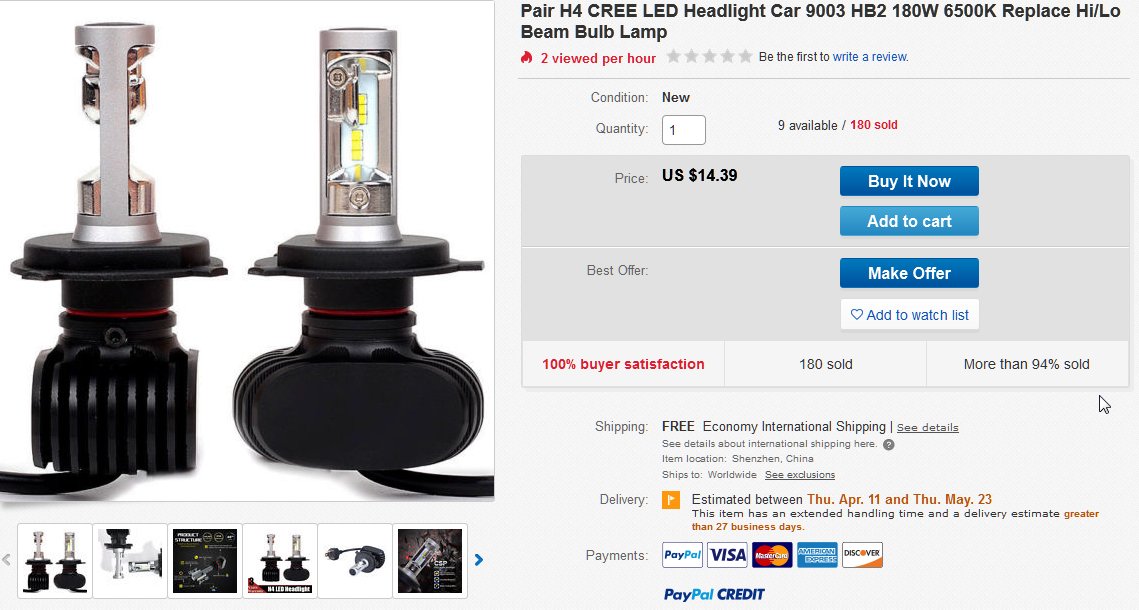

    The product does not work, just like the rest. All these LED companies claim theirs is somehow different and they have fixed the problem, but unfortunately they cannot defy the laws of physics and even making such a claim demonstrates a lack of understanding of lighting optics, or that they just don’t care and are trying to make a dollar off your back. Not sure what is worse.
    Moving the LED chips off center and using a directional light source changes the geometry of light in the entire housing. As in everywhere the light is hitting the reflector is now at the wrong angle, which produces glare, so those glare guards attempting to emulate an H4 don’t correct the issue. This is a geometry problem as mentioned before.
    I can guarantee you it does not have a cleaner cutoff. Ironically your photo shows this, in that street sign that is glowing radioactive that you have crossed out which looks to be at a distance that it should fall below your low beam cut off.
    This upgrade will provide much better output, superior distance projection, less glare and cost half the price. Because it is using the technology the housing is designed for.

    From their website: "The GTR Lighting GEN 3 Ultra Series was developed through rigorous testing in a scientific environment measuring important characteristics such as CRI, luminous flux, amperage, wattage, and the dominant wavelength..." blah, blah, blah - the more buzz words we put the higher the price can be :puke:. The truth is that these bulbs have exactly the same principal design as these 14 dollars bulbs
    Like it has been written many times it is a simple geometry 101. Quality reflectors (and OEM reflector is high quality) are designed to have the light source in very specific position. The angle of each reflective surface is designed so the light coming from that the bulb's filament is reflected and directed to very specific point. As soon as the light source is moved from the specified in the reflector design the reflected light is directed somewhere else.
    Even with halogen bulb the geometry plays a huge role. The geometry of the halogen bulb is a combination of bulb's mounting ring and the filament geometry. This is why you need to use high quality incandescent bulbs (Phillips and Osram/Silvania are well known brands), not a cheap no-name bulbs that look like H4, but do not keep the specified geometry with accuracy of a tenth's of millimeters.
    LED headlight bulb replacement is one of the biggest scams in automotive market. They are not road legal and they are worthless regarding performance. But they look cool on marketing materials and very convincing to unsuspected buyers. But once you buy it and try it there is no other option then be a "that guy on the road" hoping to not get pulled over by highway patrol, dump the problem on some other sucker (via CL for example) or just swallow the loss learn from mistake.
