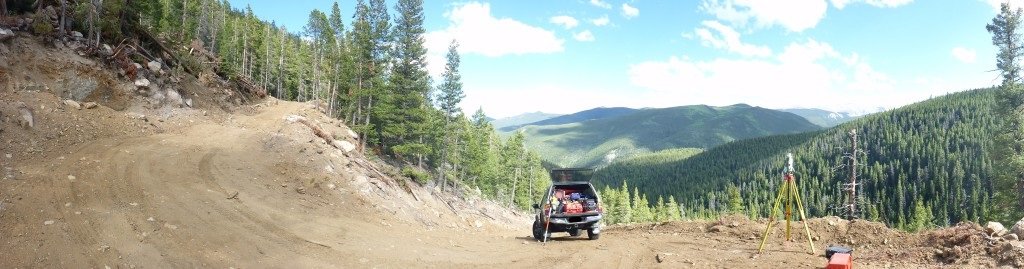

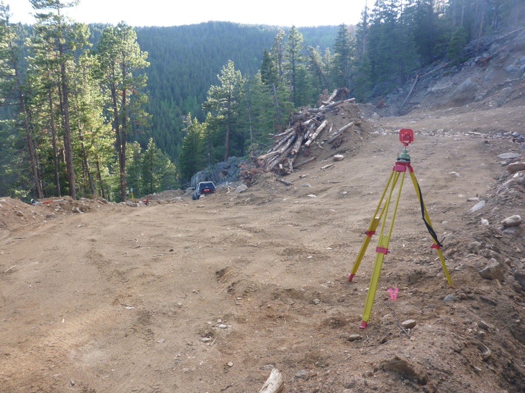

    So I found some photos of this one fairly steep construction road someone cut up the side of a hill. My memory said lots of jagged rock. LOL, not so much. Yeah, there are rocks in there, but it is mostly a steep dirt road, with rocks / gravel mixed in. So my off road requirements are probably somewhat more modest: moderate 4x4 trails, steep construction access roads with large gravel / small rocks, construction mud, snow a few months out of the year (with packed snow / ice / slush on side streets), and lots of highway driving. Would be nice if I could get back to 20+mpg on the highway.
    I'm strongly considering (as in probably am, unless someone convinces me otherwise) to go to a slightly narrower tire, but with same diameter as the 16" OE tires: 245/75R16. I give up only about 0.7" wide tread patch (9.8" for 245/75R16 vs 10.5" for 265/70R16) for a 6.3% reduction in "flotation," but the guys on the Skinny Tire thread sure seem to like slightly narrower tires.
    After spending a day on this topic, my priorities have become:
    1. Cost
    2. Dependability
    3. Off-road traction
    4. Winter / snow traction (incl. ice / icy conditions)
    5. Gas mileage
    6. Wet road handling
    7. Noise
    Question: Are LT, C-rated tires worth the extra expense? Or should good P-metric tires be adequate? I'm trying to decide if I'm getting hung up on "gotta have an LT tire." I don't think I am willing to pay for an E-rated tire in gas mileage. For the cost savings in P-metrics, I could afford a brand new spare, or put the $$ in the piggy bank, should I blow a tire out and need to replace it. The more I think about it... the less I think rocks are the real worry, and the bigger risk might be a stick or stump or branch through a sidewall as I pick my way through down timber at a potential homesite. Or maybe rebar, nails, or other metal scraps around foundation / construction sites.
    From a "internet chat representative" at the tirerack.com website today, the rep stated that you typically only get 3-ply sidewalls in an E-rating tire. And many E-rating tires only have 2-ply sidewalls. And P-metrics typically have 2-ply sidewalls. Though C- and E-rating tires have more rubber in the sides.
    Here are some photos of my Taco working:
    Along a construction access road cut into a hill up to a potential mine (along Hwy 107 on the way up to Mt Evans):

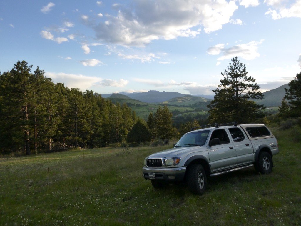

    A typical high alpine meadow up around 9000ft elevation. The grass / ground is soft & the client didn't want me leaving ruts. So it is important to 1) not get stuck and 2) not spin the wheels. Typically I used 4Low (no locker) and just crept along nice and steady.
