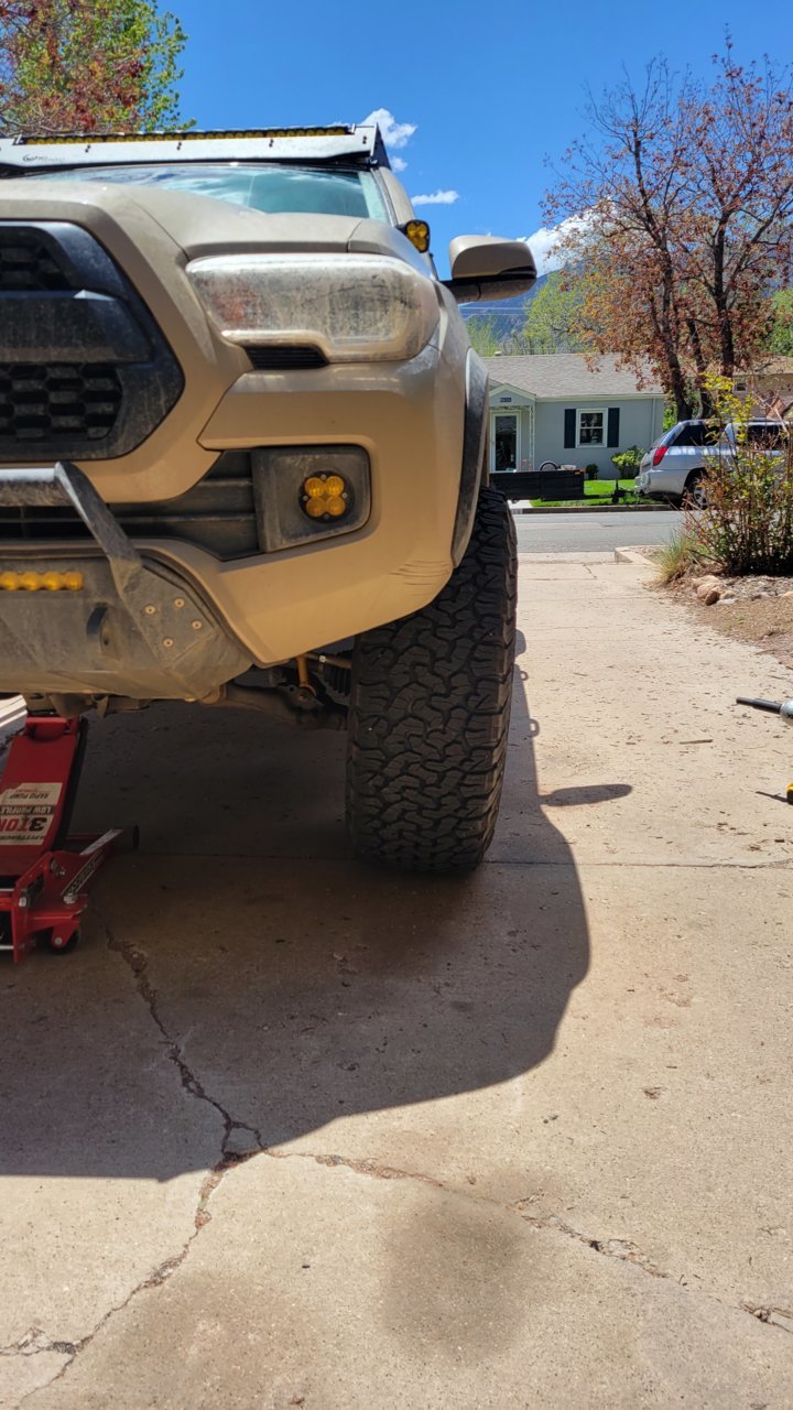

    This is an insane amount of camber and I can't seem to get rid of it. Will be taking it to Solar Automotive on Monday, but this doesn't even look safe to drive on.

    The LCA cam bolts are set correctly. However, you need to zero the toe by adjusting the steering tie rods before attempting to set camber. When the front LCA cam was moved, it caused a lot of toe-out.

    I recommend Rex's tire. There's a guy there most use for aftermarket stuff. Probably the 2nd best alignment tech in CO

    Ahh, and it's a lot closer too. Will give them a call and see what they say. Thanks man!
