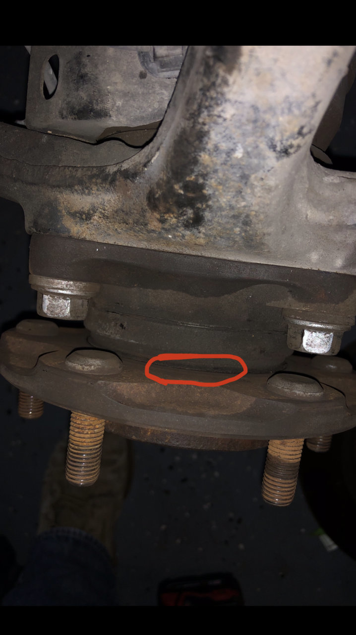

    I think that my wheel bearing has gone out on the front left of my 2010 Toyota Tacoma 4wd. It makes a clunking and screeching sound while driving. There’s also play in the wheel itself when I place my hands at the 12 and 6 o’clock position and push/pull it. Also in the picture is where the free play is at, marked by the red circle. You can also see it in the video. I just want to confirm that if I swap out the wheel bearing/hub assembly that this problem will be fixed. Thank you for your time if you’re able to help out.

    The play is definitely a wheel bearing issue and more than likely the noise is coming from that as well.

    That’s what I thought but since this is a first for me I wanted to confirm before ordering parts. Thanks a lot man.

    Just order a preassembled unit. There is a guy on here that sells some pretty good ones. I was in a bind and just got some parts store brand ones they are working pretty good.

    12 and 6 play, also check you lower ball joint as well!!!!

    I would highly suggest replacing the wheel bearing as a whole hub assembly. It comes assembled already with the hub, bearing, seals, and mounting bolts.

    2nd replace the entire assembly.
