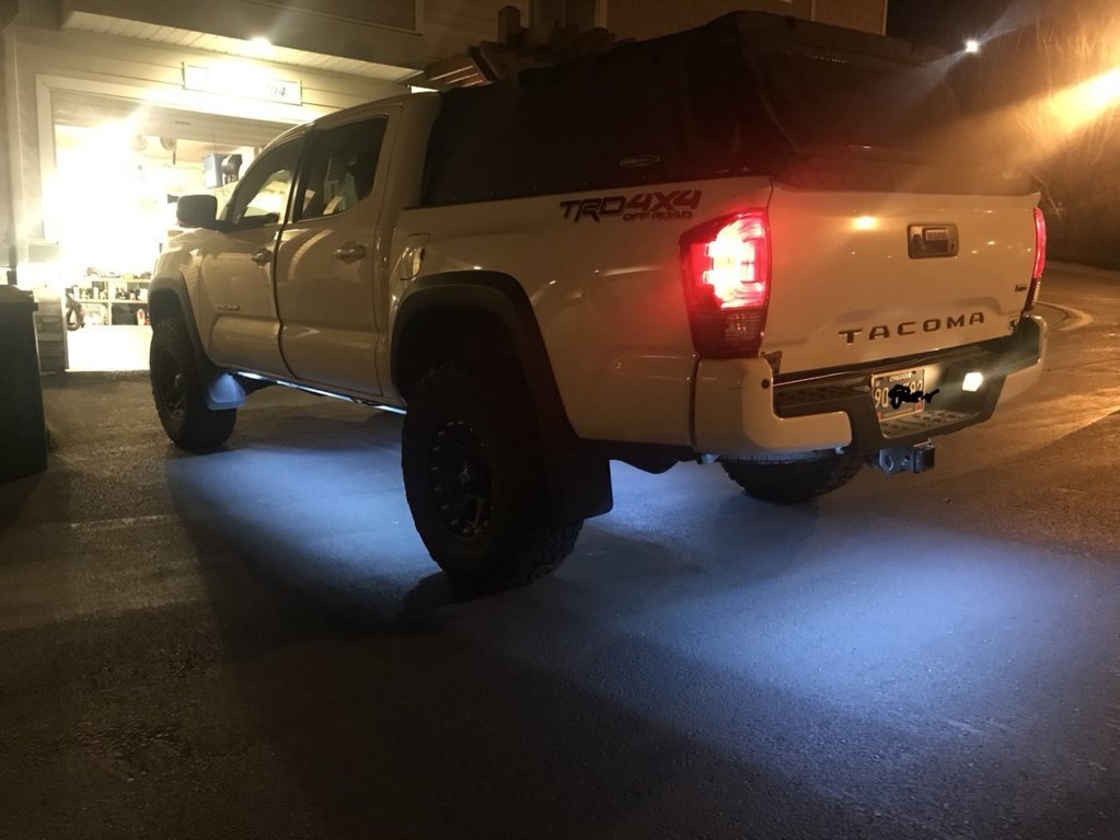

    I ran a relay that turns on the under lights whenever the truck bed light comes on. Which is whenever you open the door or use the bed light switch in the cab.

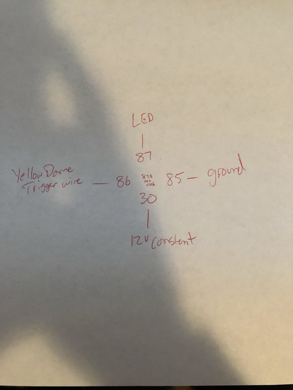

    would this work to make the underglows come on with dome lights if i wired a relay like so?

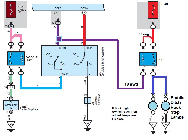

    Yellow wire is ground...tap into the Purple wire of the Cargo Lamp harness...Battery-fuse-Y wires one appropriate to added circuit, the other 18 awg to the 86 pin. 87 pin to your underglows, pin 85 to the purple wire.

    so 86 and 30 will be power? kind of confused :/

    Yes just like the OEM Cargo circuit to the left...

    86 - Negative trigger dome
    85 - 12v+ Constant (Battery)
    30 - 12V+ Constant (Battery)
    87 - Output
    And a capacitor across the relay coil to eliminate chatter. The negative trigger is a PWM from the computer to dim the dome. If you dont use a capacitor then the contacts will go back and forth causing chatter.

    Hopefully you don't buy/use a relay with an internal diode...if you do then 85 is NEG...
