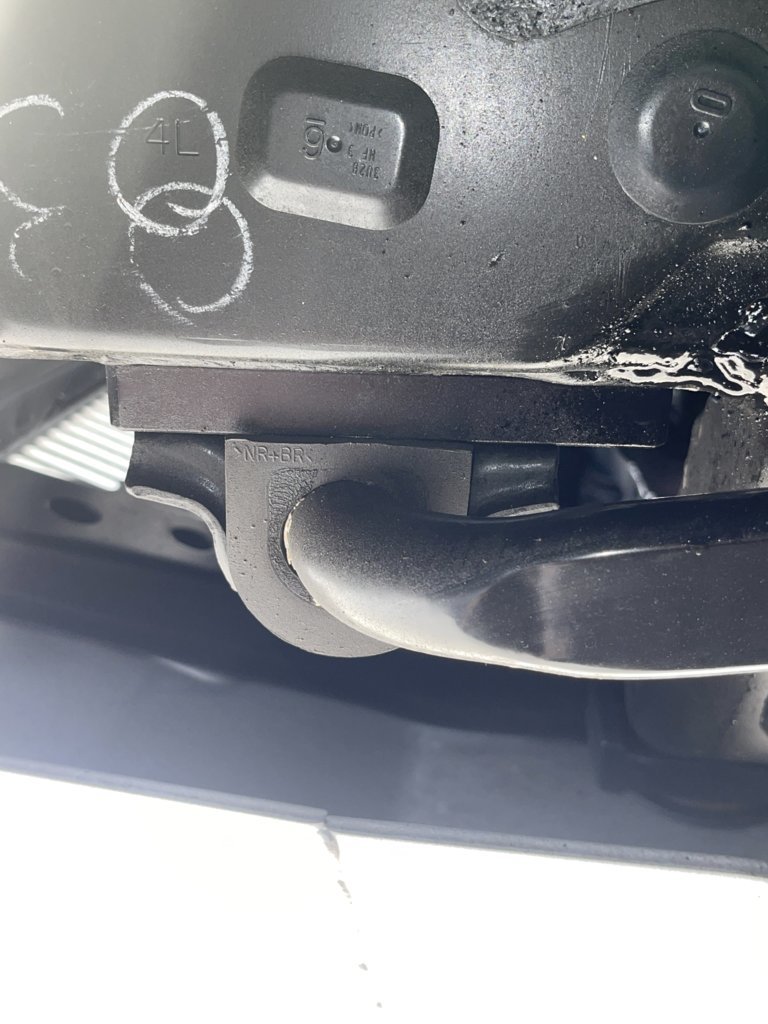

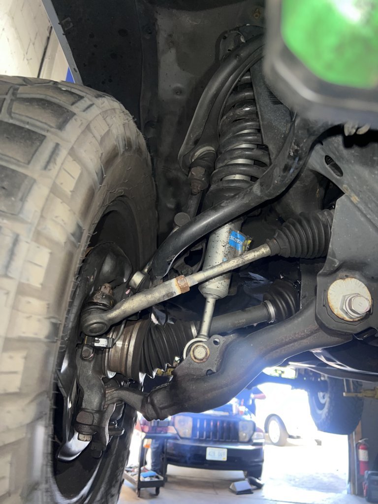

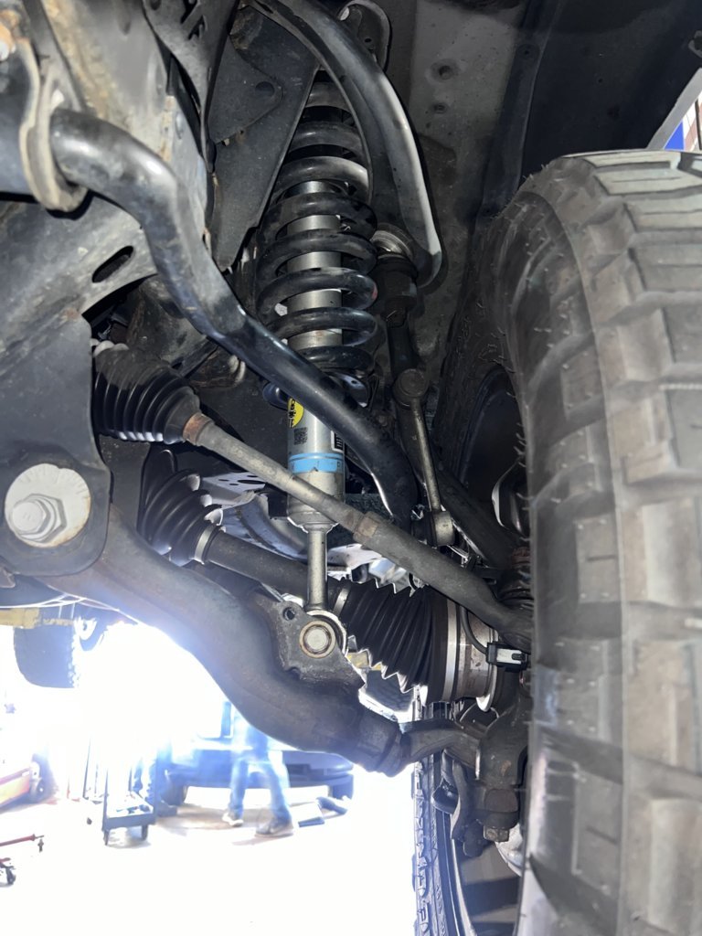

    Hello everyone I have a 2020 Tacoma TRD sport on a 3 inch rough country spacer block lift and along with that on Bilstein 5100 0-2 inch adjustable front and rear struts my cv axles keep ripping and I see that my left shock absorber is bending my mechanic says I need to buy some upgraded parts to get more clearance and avoid this from happening because there is to much tension on my suspension what parts should I get to fix this I keep seeing upgraded upper control arms but not sure if just that will fix the issue?IMG_1658.jpg

    That’s on the mechanics shop lift.What does it look like on the ground under load? Stock UCA is contacting spring on one side at full droop. Are those stock springs on the 5100s in front? Also concerned about the steering rack. But again that photo is at full droop. An aftermarket UCA would help with clearance around the coil spring but could make it worse by allowing more downward droop. I’d also check the bushings in the Lower control arm, if they are blown out it could be allowing the extra droop. Also check the upper and lower control arm ball joints and especially the ball joint boots. Remove the sway bar until this is sorted, it’s just in the way. You can add it back after you’ve got this figured out. I’ve run 2”+ lifts on every Tacoma I’ve owned and had some issues but all were able to be resolved. If your running rough country they actually make a decent aftermarket UCA that is in a reasonable price point.
    Passenger side tire looks worn differently as well?

    Waaaaaaaaay too much lift for your upper control arms. You need aftermarket uppers immediately.
    I dont know how you havent died this setup is so bad. The longer i look, the more my head hurts. Look at how the Uppers are bending the coil springs out of seat, and the tie rods are maxed, the sway bar end links are going to explode at any time….how the hell did you even get all that mashed up in there?!!
