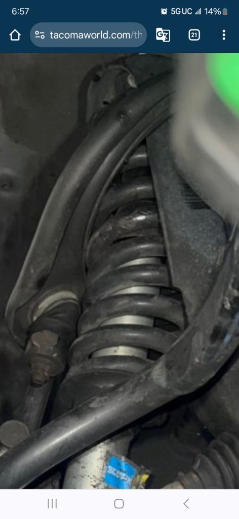

    Your poor coil springs. Spacer lifts cause your upper control arms to bind against your springs. Smashing them every time you articulate.

    Don't put spacer on top of 5100. If you want 5 inch lift, you need a drop bracket style lift.

    Holy crap! I didn’t notice that bend in the coil spring the first time I looked at the pics.
    OP, I suggest you replace those spacers with smaller spacers or (better) take them off. You are drooping too far and causing bind in your suspension components. They have a limited range of motion and you can’t change it without spending $$$. An aftermarket UCA is not the solution.

    This thread is all kinds of special. Remove the spacer lift and put the Bilsteins on the top knotch. Get you all the lift you need since you already know they are "adjustable".

    Remove the spacer. At full droop it's like every single suspension part is touching at the same time.....this can't ride good at all.

    I bet this thing has some nasty clunks going down the road.

    Yeah, like the sound of that upper clipping the coil is the first thing that comes to mind. Let's hope that OP either just went for it on their own and didn't understand suspension geometry, or they are trolling us.....because if a shop installed that....they need to be closed down.

    Even without bilstein 5100's, larger spacers do this by design. Every tacoma I've seen with spacer lifts have rub marks on the spring from the UCA making contact at droop.

    OP - The advice to take the spacer above the Bilstein "coilover" off and live your new life with only 1 or 2 inches of lift is solid. You will be much happier and richer.

    The only reason I can think of to combine a preload-based lift with a top hat spacer is to help fit 35’s without a tub or body lift. I’m not even sure if it would work, but I have considered it. If tried, one should definitely cycle the suspension to make sure nothing binds and the shocks don’t limit up travel.
    Otherwise, you should use one or the other. They are mostly redundant.
