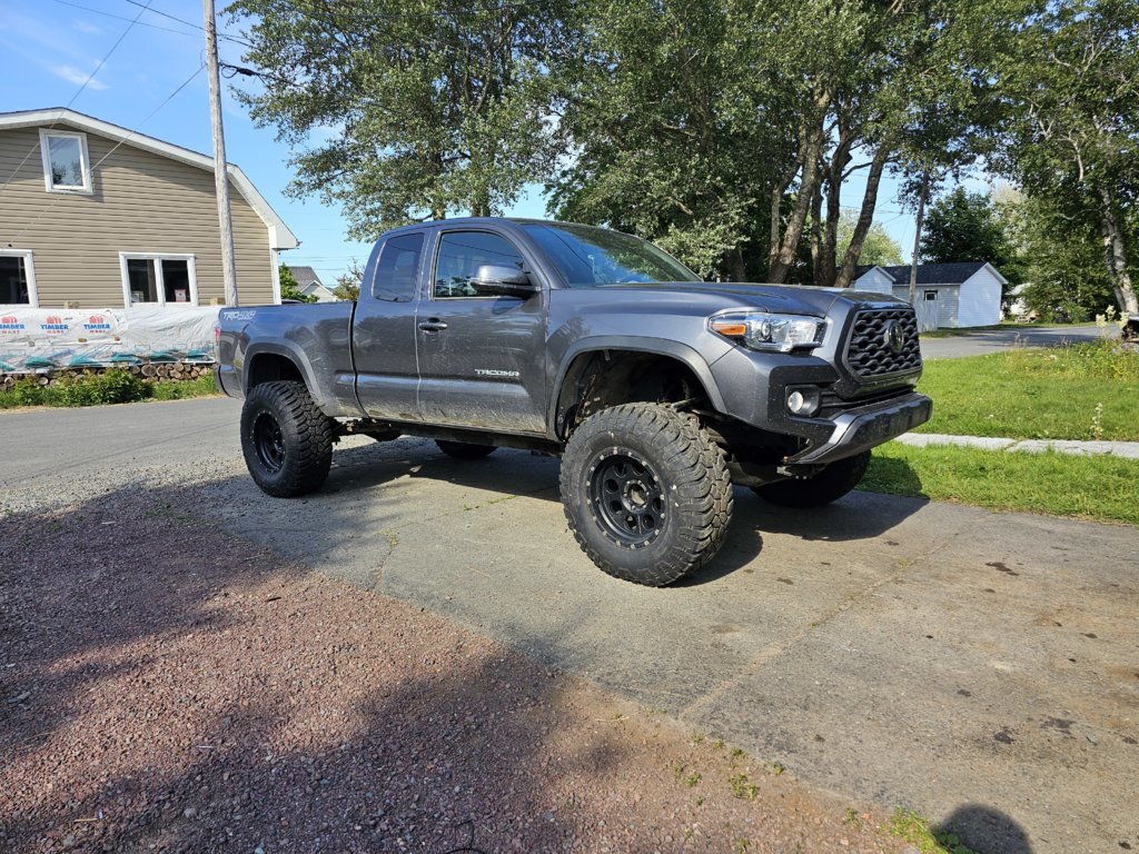

    Gonna give OP the benefit of the doubt and assume he means he has 3" blocks in the rear only, and using 5100's for front lift. :notsure:

    The UCA would not be binding on the coil over if he only had (the correct) Bilstein 5100s in front. They are manufactured to fit the taco.

    Is it just me or does it look like the passenger side spring perch is upside down?

    I just saw that

    I’m not familiar with 5100’s but the two sides do look different. You might be on to something.

    Yes, passenger side is definitely upside down
    The driver side looks much newer too, so I bet the old one used to be just like that too

    Looks like it. Also their lower shock bolts are installed backwards. Not a big deal, but a pet peeve of mine.

    you add bump stop spacers not strut spacers

    Yes, bump stop spacers are a decent solution, but they reduce suspension travel. Top hat spacers maintain full travel at the risk of binding and extra stress on the cv joints. I haven’t yet decided either way.
    To be clear, the top hat solution might also require bump stop spacers to avoid the shock being fully compressed.

    pretty much anything over a 3/8" thick strut spacer will infact bottom the shock itself out (roughly. on the shock).
    but isnt limiting uptravel not the goal you wanted to clear 35s? because if you have the same range of uptravel then it really isnt helping you clear the tires besides at a static ride height
