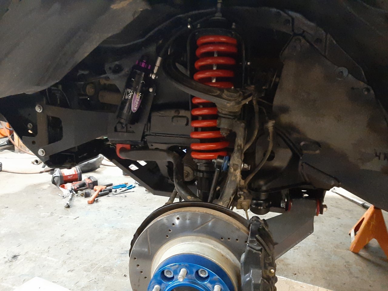

    You got any pics of how you mounted and what settings you’ve found to be good for like gravel/washboard/ highway driving?

    For settings re bound is about 3 full turns high comp is at 5 low is at 4. I have alot of weight. Handles washboard no problem but I also air down to 17 psi
