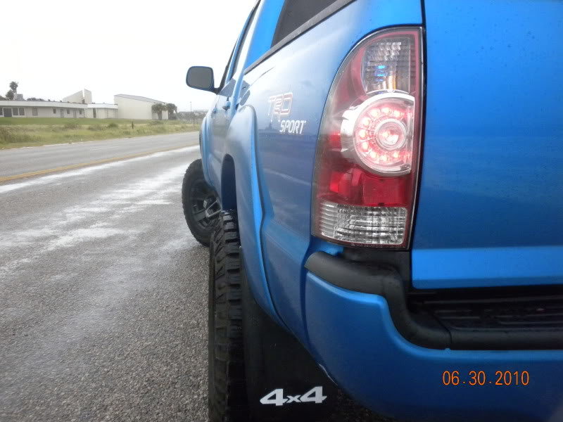

    Welcome to TW! I believe the 4.5" backspace should stick out more. I also have a 3" lift in front and have the same wheels in 16x8 with 4.5" bs with 285/75/16 KM2's and i love them. In my opinion, they stick out just the right amount. I just had to cut a small piece of plastic inside the fender well and now have no rubbing. Not sure if you can really tell how much they stick out in this picture, but it's the only one I have right now. I'll try to remember to take a couple more so you can see better.
