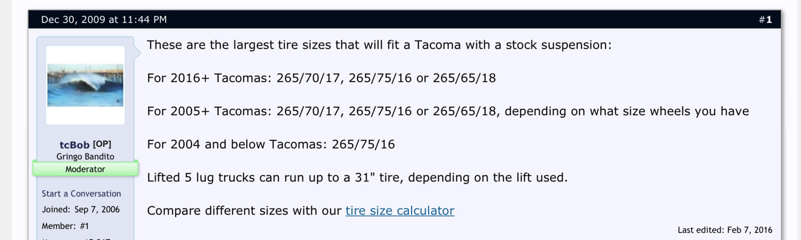

    That's what the website simple tire said after I had ordered them I noticed it and little black writing on the bottom also when I tried to order them on Walmart.com it said they will not fit my truck so when I go to order them and put my make and model and it tells me they won't fit and I just didn't want to have a problem after I put them on

    They should fit.
    I mean 265/60/18 is smaller than 265/65/18…….

    They will fit fine. Even larger tires than that would fit fine. Don’t put all your faith in the Walmart “what fits” generator.
