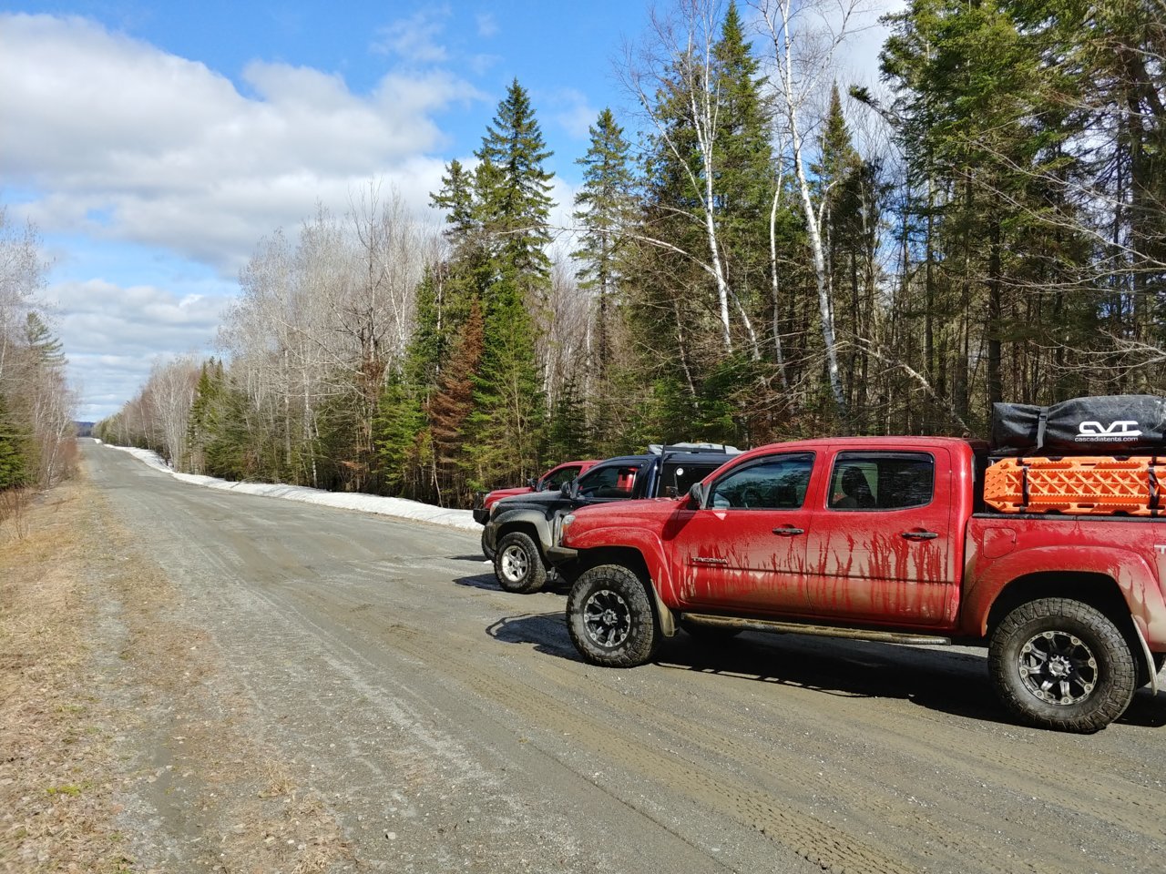

    255/85/R16 Falken Wildpeak MTs, Mobtown sliders, ARB bar, SOS front skid, Icon RXT leafs, extended & adjustable Kings, JBA UCAs, OVS wedge RTT, dual AGM batteries, Gen2 xrc9.5 winch, CB, GMRS, S1 ditch lights...
    What you are describing sounds a lot like riding around on old logging roads, which is the majority of what I do.
    To try and answer your questions directly (based on my experience):
    -Yes mid travel is fine
    -Cages are for high speed rollovers and crashes, I'm hoping you don't need that lol
    -Bed stiffeners are a good place to start. Easy and cheap.
    So first and foremost I would say this: get out there and do it. Whatever it is, get out and do it. Take it easy at first, learn what the truck can do. Have some proper recovery gear with you (an extra truck with a winch is always great to pull you out), some water, some food, maps, consideration for where you are (cell service or not..) etc etc.
    From there you can make better decisions and direct your hard earned fun stamps into the truck as needed.
    As I said earlier I typically run old (and new) logging roads up north. I push the limits of what I feel comfortable with, so if road conditions are ok and visibility is good I can easily roll 50 mph across ok roads, sometimes a lot higher. I've had my truck in the air before, and I've also done some slow rock crawling in NH and VT. Nothing crazy by the standards of some guys on here, but still made me buy skid plates and made me super thankful I had good sliders on at the time.
    I think another thing worth considering is where are you going to be wheeling? Here in the NE we have a lot of very small trails. LT and 35's would be great for the rougher roads and big holes, but thats a lot of extra width to be fitting down the trail. Also its a huge investment haha.
    As far as weaknesses, yeah the core support sheet metal is kind of weak. A lot of guys do aftermarket polyurethane bushings as a fix. Personally my feelings on that are still mixed at best. Being smart about where you add a second battery (if you do) can help a ton by spreading that weight out. The CV axles on these trucks are known to be a weak point in the drivetrain. If you think you'll ever be into the rock crawling type of stuff and if you have a heavy right foot, Id probably carry a spare one of those as well as the tools needed to change it.
    What else... Bed stiffeners as I mentioned. Lifting is known to cause drivetain vibrations. Getting the u-joint angles all matched up on the rear drive shaft with a digital angle gauge and shims will help that. Maybe a new carrier bearing too. Look into the ECGS bushing for the front driver side CV. If you do a lift that will probably be the first thing to let go on the front end. A CV laso and big ass prybar will help a ton removing the CVs from the diff. Oh and tires. If you have E range tires airing down to 22-25psi at moderate speeds will be better than $2k worth of shocks alone
