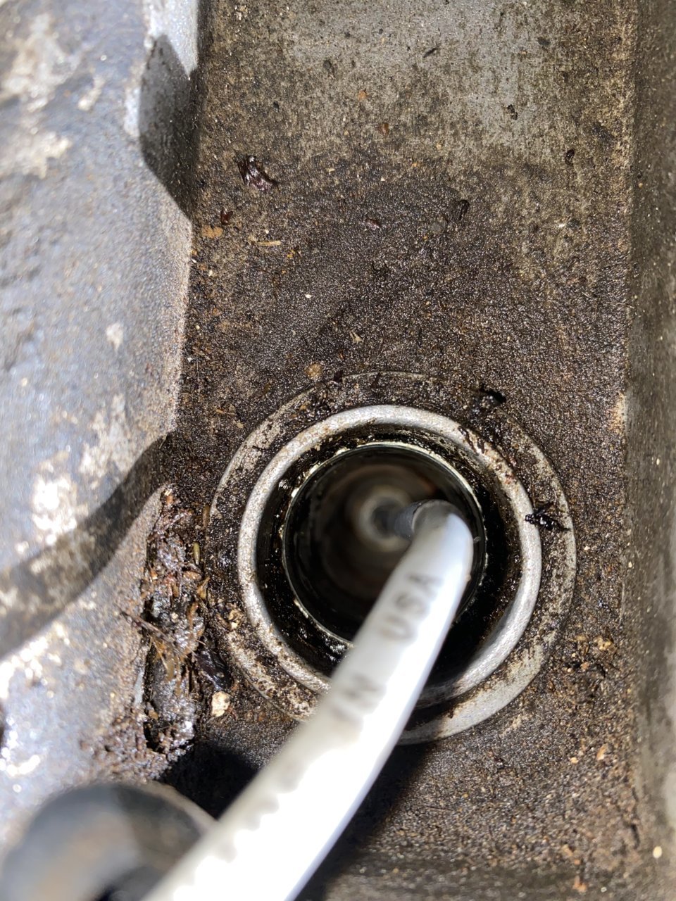

    Stupid question but have you checked all plug wires for burs where they could jump fire? I had a similar issue on my 99’ took it to several people and they all said vacuum leak vacuum leak vacuum leak even with the P0301 misfire code. One of my dads mechanic buddies came out, popped the hood and said change your wires.. instantly ram like new.

    Gotcha. Seems strange it worked then didn’t work. Which is what mine did , mine was jumping fire in the head right before the wire connected to the plug.

    Can’t see the spark because of the flash but it was all the way at the bottom. Good luck buddy!
