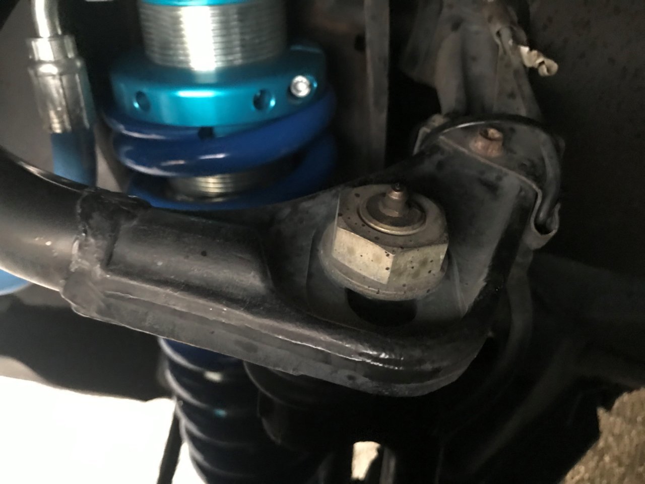

    Alright TW, I could use your help to try and diagnose a front end noise I have been trying to eliminate for some time now.. Here is a link to a video with sound:

    Issue started back in October of 2019 when I first thought my SPC UCAs might be the culprit and sought out advise on this thread:
    Front End Suspension Clunk After LR UCA's https://www.tacomaworld.com/threads/front-end-suspension-clunk-after-lr-ucas.528560/
    This was not the issue, as I have brand new Dirt King Heim UCAs and SPC confirmed I did not receive any of the bad batches with bushings issues.. the noise continues..

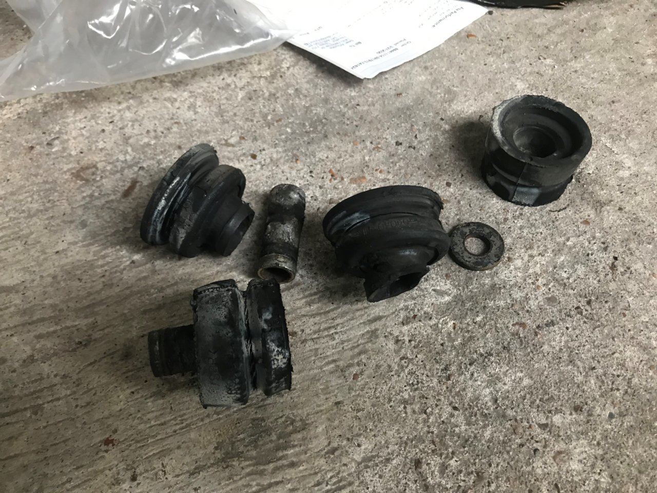

    Next, I read the numerous posts/ threads related to the RAD Body mount issues a lot of members encountered over the years..
    Old Mounts:
    New Energy Suspension Mounts:
    Problem still exists....

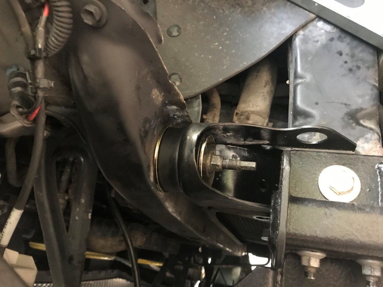

    -Dirt King LCAs - (Dec 2019)
    installed by local shop who was already replacing every seal, gasket, timing chain, belts, and etc.. in the Toyota kit for the high mileage "engine refresh" - Started with chasing down oil leaks.. Anyways, turns out those idiots didn't install the zerks and probably didn't grease them.. I have installed zerks and greased the hell out of them. The noise existed prior to the LCA swap but figured this info could help..
    -Dirt King Heim UCAs - (March 2020)
    All zerks installed and greased appropriately.

    Last night after replacing the RAD mounts I laid under the front end, put the floor jack under the front frame cross member and proceed to cycle the suspension (tires on the vehicle still and not on jack stands) to try and identify the culprit.. This was really hard to zero in on the origin of the noise.. But it seemed to be coming from the coil bucket mount area/engine bay..meaning I was not able to exclude the UCAs (maybe wrong washer used-causing binding in the bushing)..doubtful.. I have greased /lubed every potential suspension component/joint I can think of..

    Update: Issue has been resolved.
    This problem is why my dumbass will not have any shops do work on my truck that I can do myself.. So, while my truck was getting all the engine seals, gaskets, belts, and timing chain replaced my Dirt King LCAs just happened to come in the mail. So me being impatient, I had the shop doing the other work throw these on for me... Bad decision.. Turns out those dipshits did two things incorrectly.
    One, they didn't even install the Zerk fittings included in the kit from DK... I am also dumb for not catching it sooner and for obviously not "trying to" at least grease them regularly during my oil changes.. Two, they also didn't include the spacer washers that go on the outside of the through bolt between the lca arm and the mounting position... To make things worse they over tightened to compensate and bent the LCA mounts.. All that being said, all corrections have been made and noise is gone.. Still have a little bit of a squeak but sounds like typically uni-ball noise and nowhere near as bad prior.
