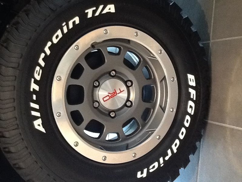

    I have a couple of questions, I tried searching existing forums for answers but i couldn't find anything, so here it goes.
    I have a 2007 DCSB TRD off-road, currently sitting on stock suspension, wheels, and tires.
    First I want to run the TRD pro/Tundra TRD/FJ wheels, the ones in the photo I've included. image.jpgIve seen them on tacoma's before so I know they make some that fit, but all the ones online I've managed to find don't seem to line up with the same lug pattern. Am I doing something wrong or do they make a small amount of these wheels that fit on tacomas?

    Tacoma TRD beadlock style wheels:
    http://trdparts4u.toyotaofdallas.com/scripts/prodView.asp?idproduct=-10180
    285s are likely going to rub without cutting/trimming/chopping of your truck. Look up the cab mount chop. With 2" lift, 265/75/16s (1" larger than stock) will fit much better and will avoid all the rubbing and cutting of your truck. Not to mention be lighter and provide less power and mpg loss than the 285s.
