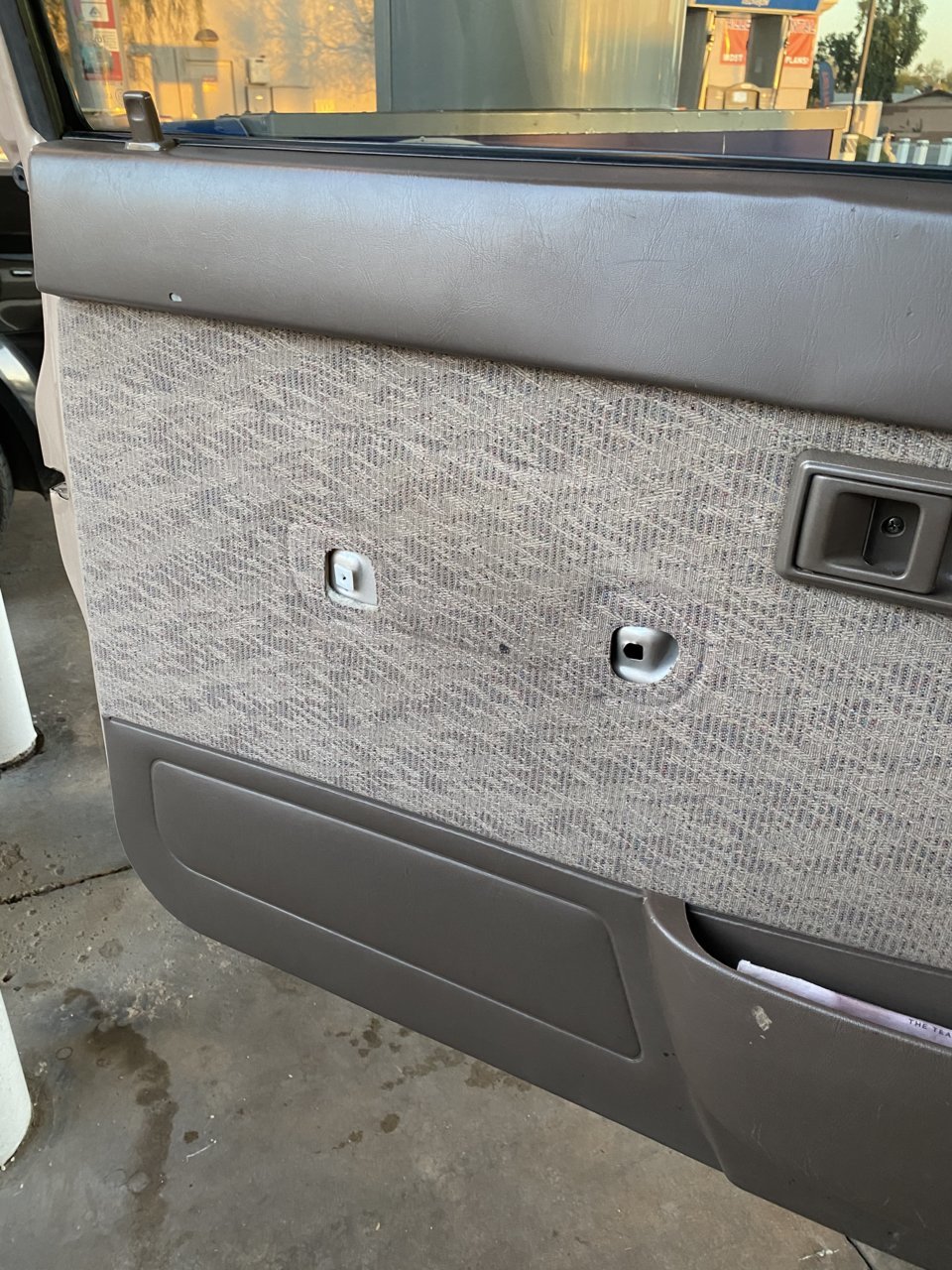

    Hey everyone,
    I’m new here and looking for some help. The driver side arm rest broke off because the clip that holds it on snapped. Does anyone know where I can find these? I’ve attached a picture to show what I’m talking about.
    Thanks in advance for you help!

    You can buy the plastic clips insert.
    It’s held in by what looks like a screw?
    If it’s the arm rest and it’s the LEFT rest.
    I found one. But do note the rest is 2 piece.
    A Lower and an Upper.
    The Lower is what is held on by the screws.
    It looks to be Part # 7423435010E0

    It's just a basic screw grommet. Salvage yards are full of them, but you need to measure the hole first if you can't find one for sale specific to your vehicle. You could likely find on on Amazon with a little digging after you measure the hole. For example, here is one for a 8.5mm x 8.5mm hole:
    https://www.amazon.com/Rexka-Gromme...ew+grommet&qid=1581993744&s=automotive&sr=1-2

    Just bring the good one or whats left of the original to your local Napa. They should have a large selection of plastic clips and such. Beats taking a guess with ordering online.

    Thank you all for your help! It is just a screw grommet.
    I’m going to look for one at a nearby salvage yard rather than ordering the wrong size first.
