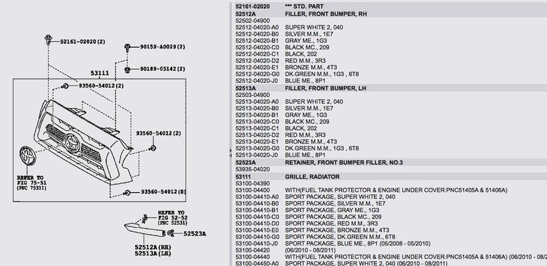

    Try this for size... this is for an '09.
    Edit: part "52523A" is the retainer for the filler piece, part number 53935-04020.

    I believe that is the one on the side that hooks to the fender. I have that one. I need what part 52161-02020 snaps into. I looked on the bumper and grill and I dont see anywhere it would attach to thats why I thought maybe there was some kind of retainer clip that I am missing.

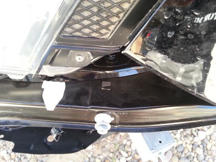

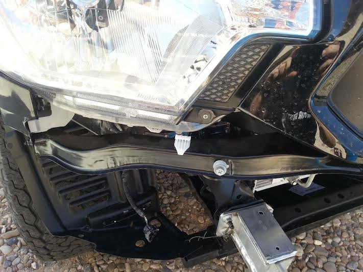

    Ok this might help, the first pic is what I am working with. On the second pic you can see the little square cut out in the metal bracket. I am thinking a plastic clip goes into that which then I can clip my filler into it. If I am way off here please someone tell me I am barking up the wrong tree.

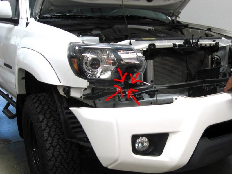

    Ok the pic below shows the the part I need does anybody know the part number.

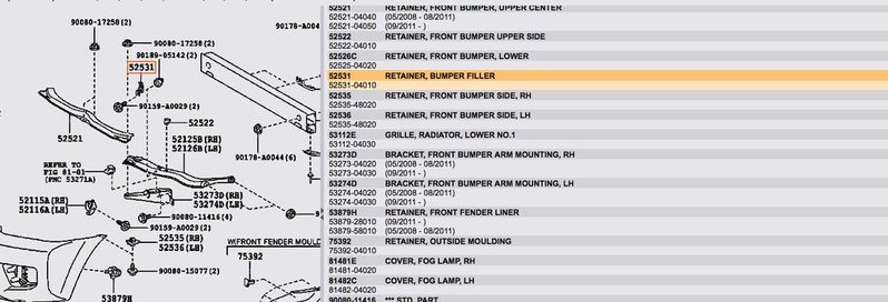

    Try 52531-04010.
    I found this on ToyoDIY.com. I could only select model year 2011.

    See attached diagrams (again, for 2011). Looks like the part you highlighted with red arrows is 52531-04010.

    '12 and newer use different parts on the front. All that stuff around the headlights and bumper is different than yours.
    Use whatever site your linking, but type in '13 for the year.

    I can't. It only provides parts reference for up to and including 2011.
    I did a quick search for that part and found this, a listing for the 2013 model year: http://www.midatlantictoyotaparts.c...ents/upper-retainer-retainer-left/52531-04010
    Also see item 8 here: http://www.riverviewtoyotascionpart...0l-v6-gas/body-hardware/bumper-and-components. Same part number for left and right side.

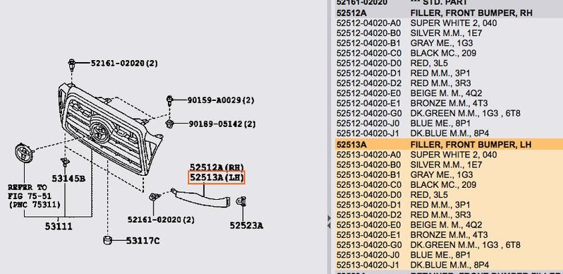

    i have complete list of parts needed when i did 2005 to 2012 mod the part you need is highlighted
    DISREGARD THATS PART FOR OTHER SIDE OF THE FILLER, SORRY BOUT THAT
    bought from octoyotaparts onebay $14.56 eacj delivered
