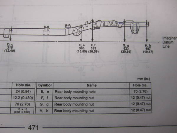

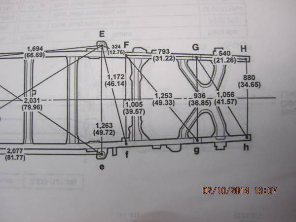

    Help me, im currently trying to plan a bed cage for my 05 dbl cab shrt bed. Instead of measuring all the frame work i was woundering if anybody had any technical drawings of the rear end of the frame or and bed? i know super random but theres a chance sombodys gotta have something, thanks guys.

    You can have it for free if you can wait until late Monday.. I can't see the dimensions on the technical site we use because "this plug in is not supported on your mobile device"

    Sounds good! I'll get you the Mitchell frame dimensions and I'll see if my 2008 Toyota body repair procedure manual has box dimensions

    These are out of the Toyota/Scion Collision Repair Reference Guide. My mitchell dimensions still won't come up because my old pos computer needs a Java update that it won't recognize. (Three weeks from now this computer will be getting thrown from the roof just like "Office Space")
    These should tell you everything though:)
