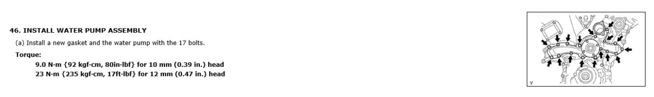

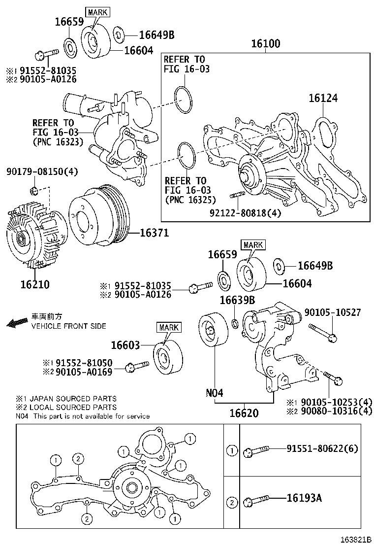

    Stumbled across this site while trying to track down a part number for my water pump and thought I'd sign up and see if someone here could help out. I have a 2005 Tacoma with the 1GR-FE V6 engine. I'm in the middle of replacing the water pump that was leaking and wanted to replace all the bolts while I'm at it, as they are fairly corroded. Every parts diagram I can find shows part numbers for the 10mm bolts (labeled 1 & 2 on the drawing), but not the 12mm bolts.
    I went into my local Toyota dealer where the parts counter guy declared "I have no idea" after 15 minutes of searching around his computer and the back room. Much digging online has yet to turn up a diagram showing the part numbers for those bolts. Anyone know what the part number is?

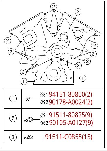

    Looks like they're # 3's. 91511-C0855 X9
    Shown with timing cover.

    no mention of any sealant on the threads
