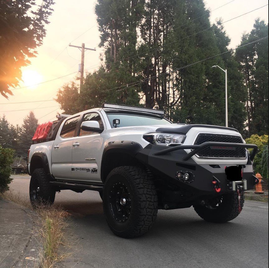

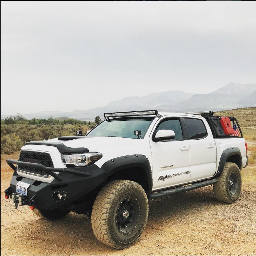

    Need yall's help to find owner/builder/whoerver worked on this truck prior to me! TAG WHO WHOEVER MIGHT KNOW THIS TRUCK
    *Issue cannot get out of negative camber. Been to 3 alignment shops and couple of lift shops and the issue is its on a 6"in lift but lowered to a 3 or 4"in? Subframe cut too
    *Background - I bought the truck in 2017 in OR. My fedex friend so happen to be driving past Toyota Broadway and saw this unloading. I went there after work and bought it. They have no story of the build. I am the 2nd owner. I believe the truck was located in Phily/New Jersey somewhere in the East Coast due to the home location on the dash GPS and couple of receipts sent there. A decal of the exhaust done in New Jersey as well. I do remember it having BDS logo suspension prior to me replacing it so I do believe its a 6in BDS lift kit
    *ResoIution - Would like to get more information so my mechanic has a better understanding of whats been done. I've been instructed by some people to reweld the subframe back on and restart from there. If we can avoid that option that'll be great. Its not at a 6 in lift/height right now and I like the height its sitting at right now (3-4in) cause im 5'8". So if the community can help me track its owner or the shops that had worked on this Taco so I can get more info whats been done it would really help to get this back to working order vs burning my tires!
    Pic 2.jpg PIC 1.jpg *Orignal Parts when I bought it - Fab Four Vengeance Front/Rear
    -Smitty Built Winch
    -XDS 18in black wheels
    - Rago Fabrication for Ditch/Bar light
    -Leitnerdesigns bed rack
    -Flow Master Exhaust
    -carbon interior wrap
    -Fox 2.0 Suspenions

    I think that unless you can find someone who has a contact with the proper agency in NJ that can run the VIN# (and is willing to do so), its not likely you'll be able to find the previous owner (maybe if you're lucky, you'll find something the PO left behind somewhere inside the truck that has an address or phone # on it).
    Best thing might be to simply post up a bunch of pics of all the suspension parts (shocks/springs, brackets, knuckles, etc.). Maybe someone here can spot whether something is bent or out of place under there.
    Also a pic of your alignment sheet printout.
    FWIW, the drop-down amount on the BDS kit brackets is 4", so that would be the minimum lift height you should have it set up at. If it's less than 4" lift, it's possible things like the camber & caster might not alignable.

    If you post photos of all your suspension components people will be able to give some input.
