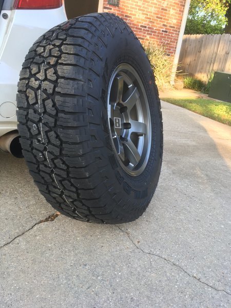

    I prefer for the falken for the reasons mentioned above : light, inexpensive, aggressive looking, great tread life, And rides well. They are tires that look better, some may perform better in extreme situations, this is one of the best bang for the buck tires in what's currently out there in a 265/75/16 tire. Both the Cooper in Goodyear Duratrac are also both bad ass tires with an excellent following here.
    Falken $140
    Goodyear Duratrac $184
    Cooper St Max $234
    This is per tire average online retail
