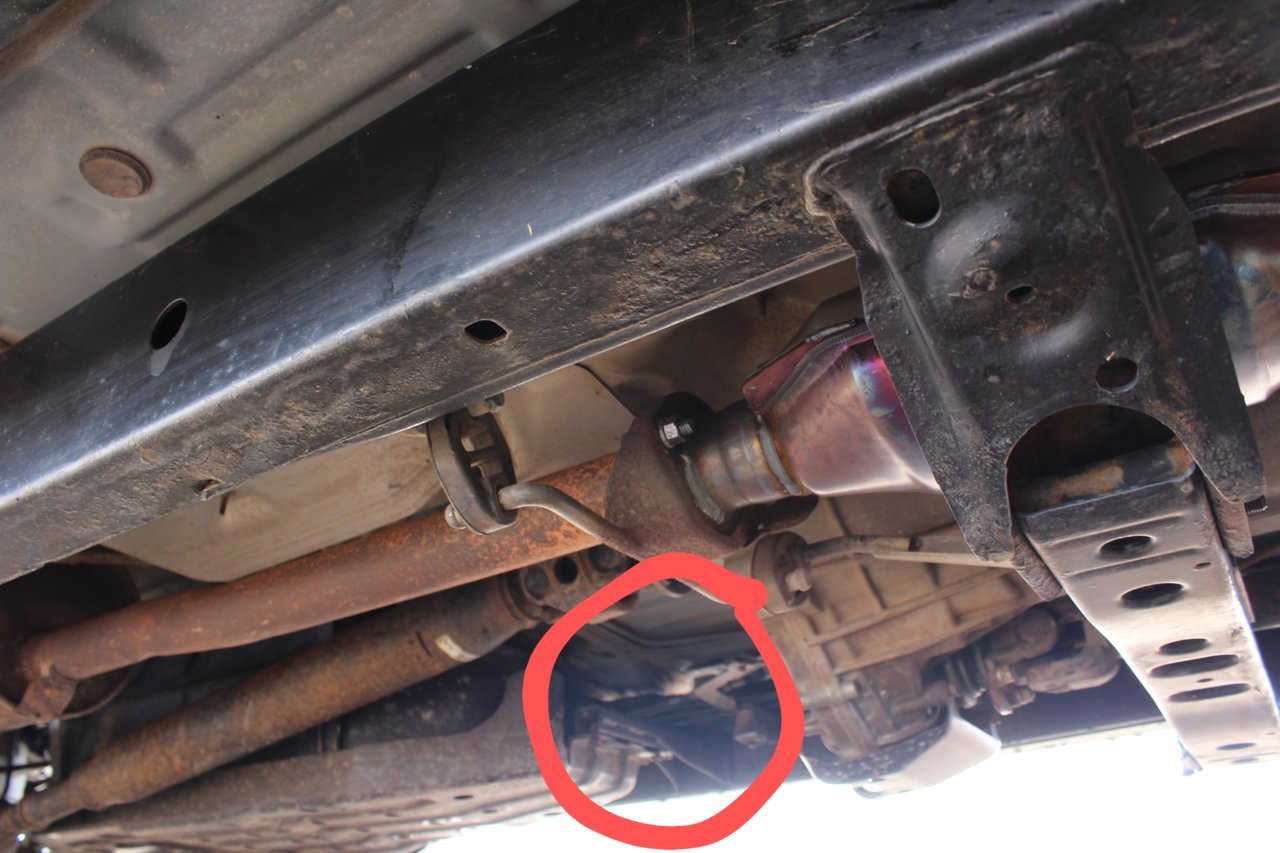

    I had this issue with my Tacoma, and for me, it ended up being the fact that over the 22 years the cable that actuates the entire system stretches. This doesn't pull the E Brake handle into the dash and doesn't allow the handle to depress the button that is needed to turn off the light. I chased the issue for a little while until I was able to track down where to adjust that cable. Along the driver side frame rail, nearly under the driver seat. There is a small lever arm and on it there is a barrel adjuster with a threaded rod through it. On the side facing the front of the truck there is a Jam nut to keep it from moving. Loosen that jam nut and adjust the threaded rod until there is very little play, but a little bit, in the cable and tighten the Jam nut. And that should solve the issue, as well as the handle will feel better when being pulled out and it will pull itself back in better.
    Sorry for the blurry photo but that circled thing is the location it is in and where you can adjust it.IMG_5737_2.jpg

    Tried for 40 minutes, worked when I first tightened it but then did the same exact thing.
    I’m pretty sure it has something to do with my cable just being way too old and so fourth. Any other ideas? I’ll try again tomorrow but I don’t know what’ll change
