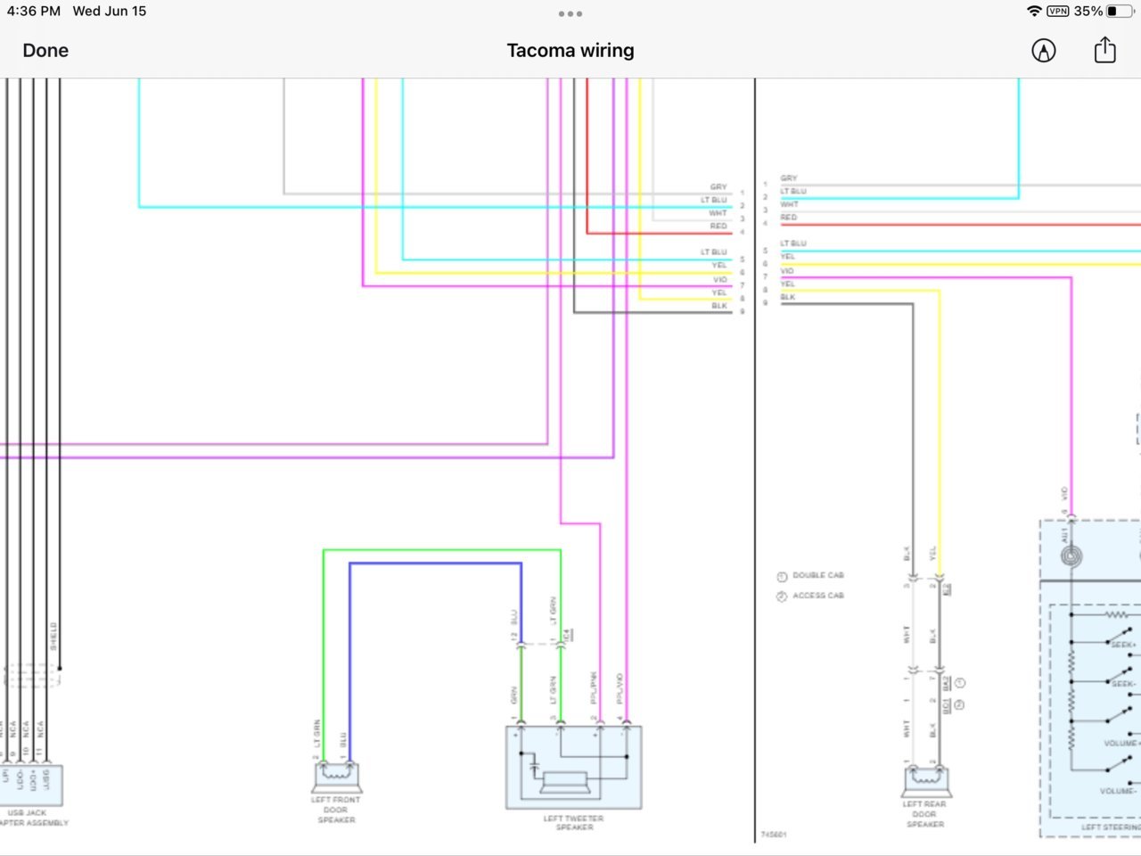

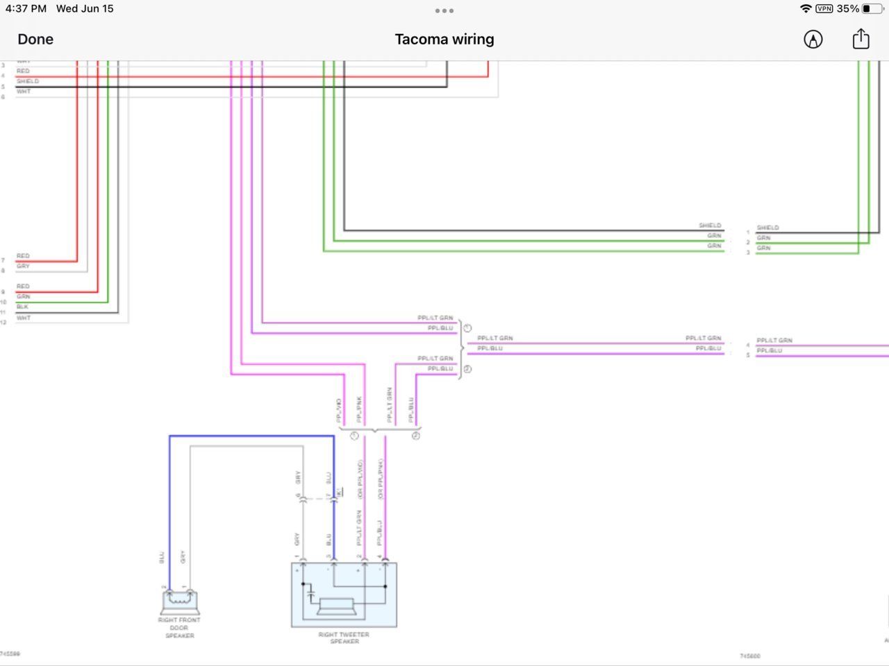

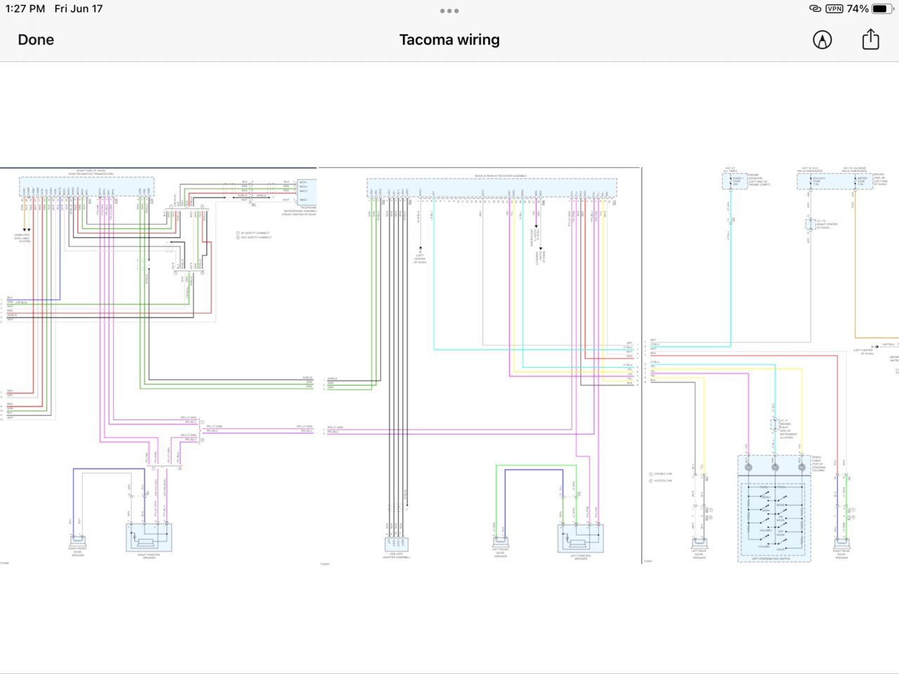

    Just and FYI, I ran my own new speaker wire from my amp but tapped into the speaker outs for the signal. I also used a speaker out as a remote turn on since my LC7I can use it. Here is the Diadram for wiring that worked for my ‘21 non JBL
