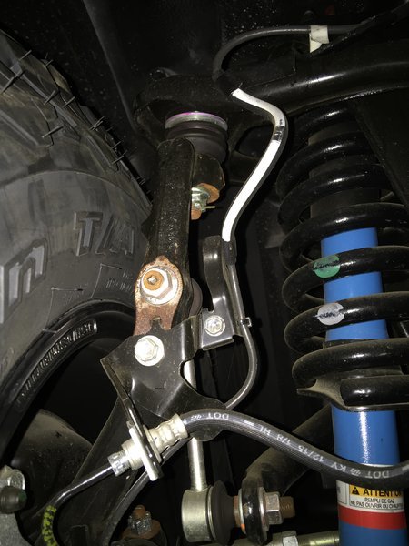

    I just put a set of fuel rims
    17x8.5 with a 25mm offset
    Tires are 265 70 17 bfg k02
    When I feel behind the tire it's super close to the steering knuckle the is a bump thing on the kunkle and my finger barely fits.
    Should I be concerned it's not rubbimg but will it if I go off roading?
    Any info would be great.

    Ya that numb that you see in the pic is close the tire place assured me that it will not rub.
    They said if it does not touch now it will never.

    Likely is ok but I'd drive one front wheel up a ramp or something to flex suspension and confirm tire doesn't rub.

    Great idea that's what I will do
