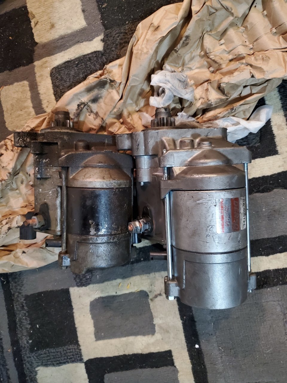

    Hi guys!, Thank you all for the useful info and guidance and the video! At the end of the day I just ended up going to an auto repair to have a mechanic do it. When he had removed my original starter, the mechanic had called me over because there was a difference in size and weight & he asked me if the new one was a 6 cylinder(original OEM being heavier, larger, & slightly longer in length). I had called to confirm with the shop and the new one was indeed a 6 cylinder. It was also a Denso brand like the OEM. Now i have researched that with the OEM starter, there is an option for heavy duty or w/o heavy duty. I'm concerned because my original starter lasted me nearly 17 years (since 2007). The idea about rebuilding it seems like one of the best options so i think ill keep it until i can find somebody who can rebuild it for me. Also can anybody provide me some links where i can get the rebuilt kit? I feel the same way as my core key components should not be replaced which i have already done so with the alternator (denso brand). I don't have this type of auto repair experience so i dont think i have a choice.
