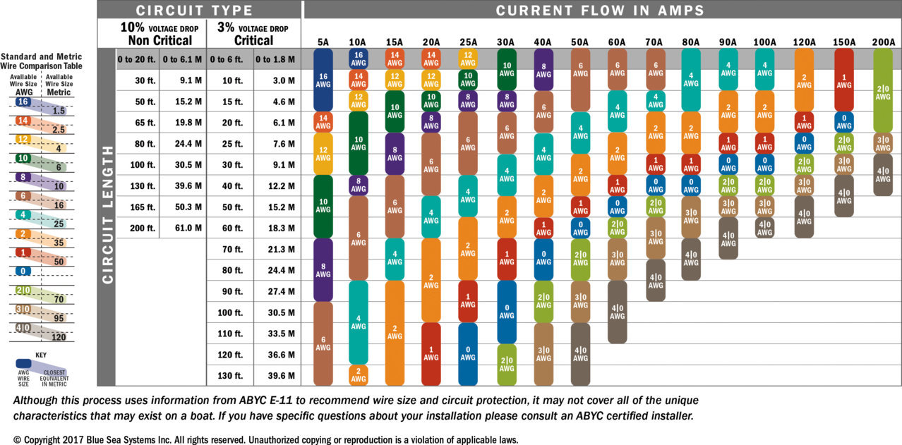

    https://www.bluesea.com/resources/1437

    Hey, so I have a 500W Bestek inverter that I use for charging the kids stuff. I too was thinking of hardwiring it in as well. It's internally fused and I was going to run 6 ga wire from the battery through the firewall and under the seat to hard mount it.
    Did you ever mount yours as you wanted in your vehicle? I'd like to hard mount it under the seat so it doesn't get cluttered with wire and get kicked around by the kids in the back seat...
    I'd also like to be able to get the full 500 watts wiring this way...
    edit: Maybe 6 ga is way to thick? But it says on the inverter that the input is DC 11-15v 49A. 49A at 15 ft on the charts says 6 ga? I dunno...

    6 ga sounds about right. You'll want a fuse at the battery end too, just in case you get a short between the wire and the inverter.
