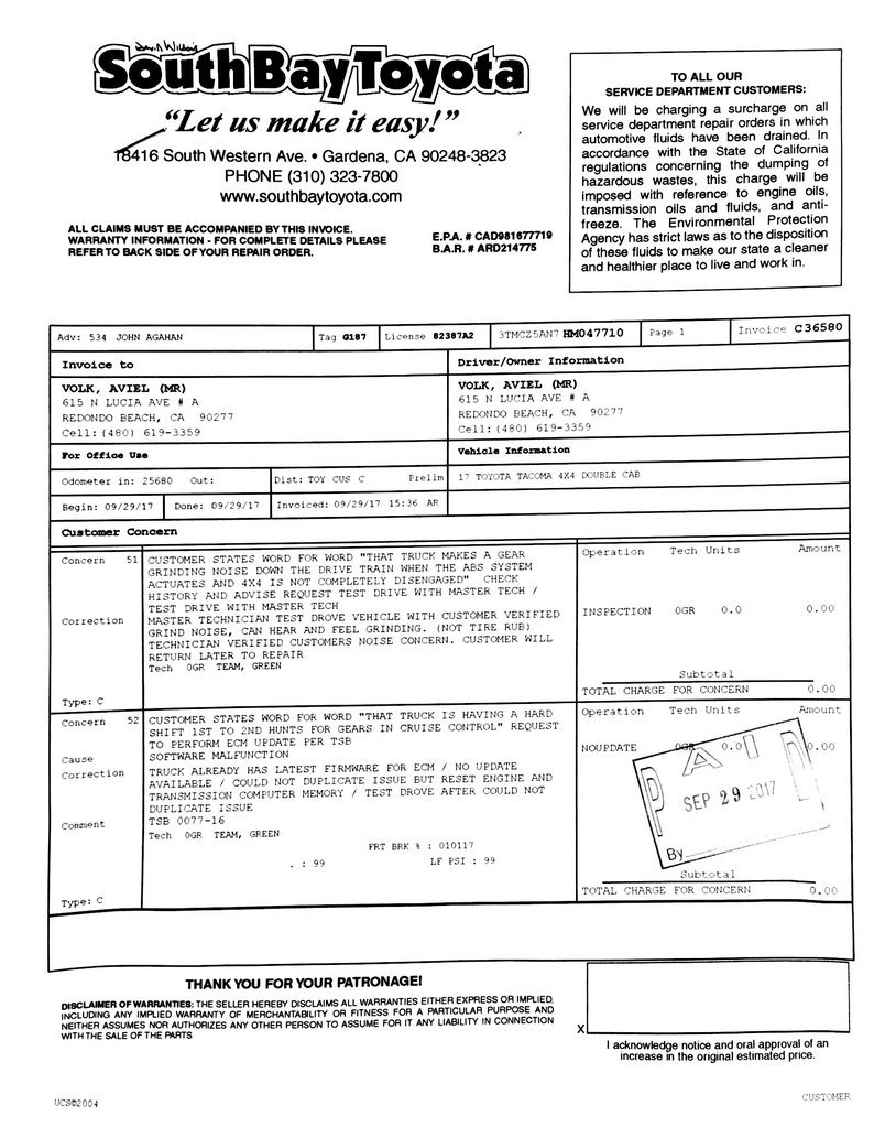

    Finally....
    So I made an appointment with a master tech at the 3rd dealership in my area... It was for 2pm and supposed to be a ride along. I show up and they are like you need to leave because that tech isnt here.... Im like "can you just have someone ride with me to listen to this intense grinding noise" the service advisor is like "nope" and I lose my ish and ask him to get the manager and finally they send someone with me and wouldnt you know... after a year..... of bringing it in and explaining it to them. asking them for ride alongs and leaving the car they finally hear it and acknowledge it.
    I made sure the tech told me and the advisor that he "knew it wasnt tire rub" or anything stupid like that so they cant blame it on random ish. It was def gears and he told me the advisor and manger that.
    Long story short. They dont know what to do. They are going to write corp to see what they think.
    If you have crappy MPG and when you go over incline/decline with a nasty grinding gear sound.... it is not normal. its related to the ABS system and when it detects slippage it actuates to limit slip which in turn grinds the gears. It could be causing damage to the tcase/ drive shaft and some gears so get it looked at and make sure a tech rides with you and you drive.. take them on steep inclines to reproduce. Dont leave your truck for them to try to reproduce as they wont even really look for it.
    He also couldnt find the hard shift even though I told them its when its cold... not after Ive been driving all day.
