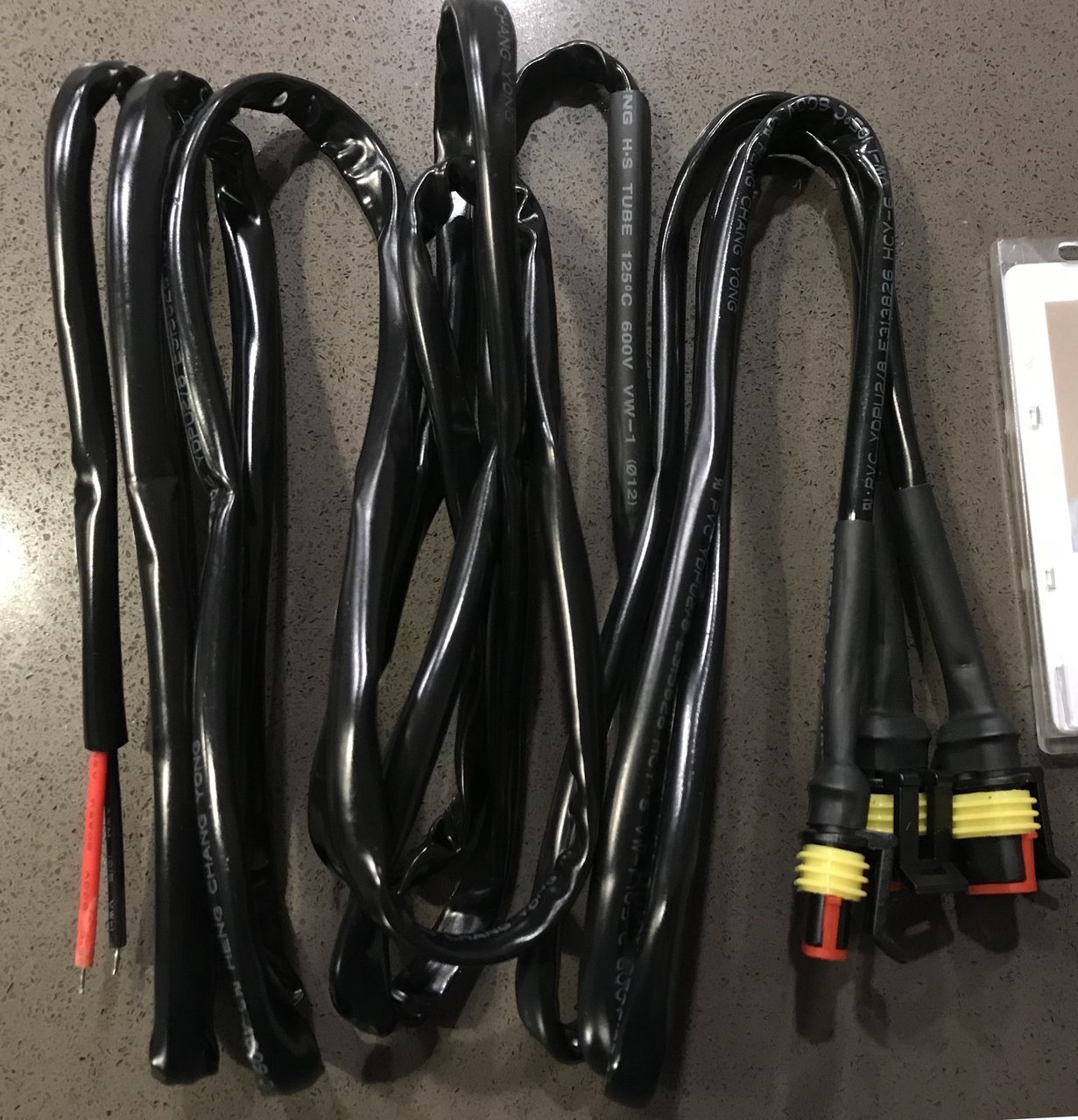

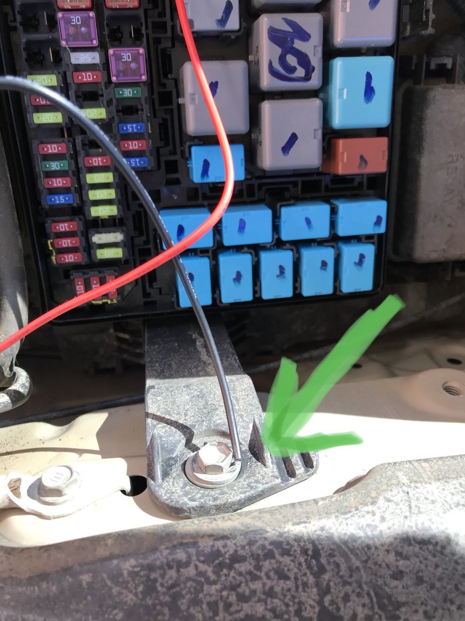

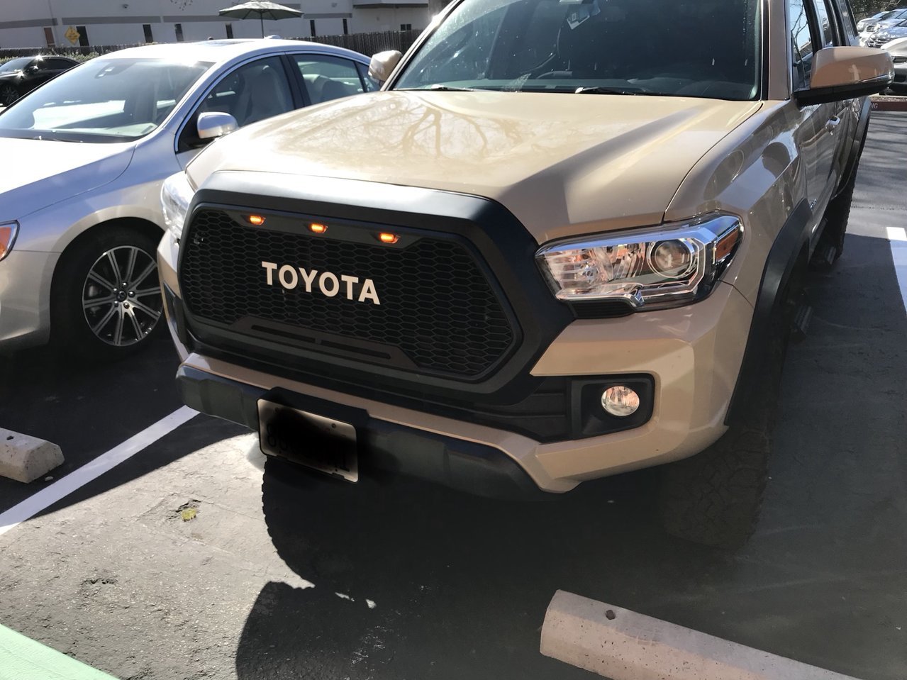

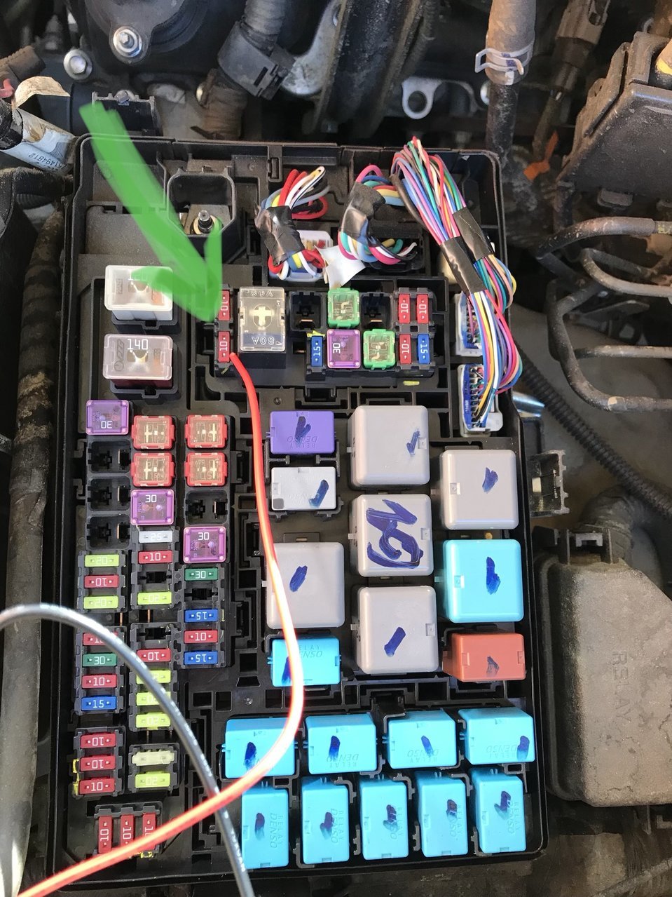

    Ok so I had my coworker help me wire the new amber LEDs for the grille. He has an electrical engineering degree and does a lot of work in his own rig, so I trust him. He said that no fuse or relay is needed. Simply tap into an existing fuse that has power when you power the truck. Here are pics of: the included wiring harness, key connect points (see green arrow) and end product.
    Hope this helps others.

    This helped perfectly. I just did the same exact thing as the picture.
    Thanks for the help!

    Yes. That’s how I wired mine. There is a good YouTube video showing how to connect
    vuTron[QUOTED][OP] likes this.

    You’re wired into the fuel injectors. I did this too as it’s the always on fuse. You’re gonna notice a drop in mpg. I went from 340miles a tank down to 290. I ended up wiring to the tail lights on the driver side fuse box so they still are always on.
    ..also for someone with an electrical engineering degree this is the most unprofessional way to do this.

    hmmm, I did not experience any drop in MPGs. You lost 50 m/tank because of 3 tiny LEDs? are you wiring anything else up?
    if it's not too much of a hassle, can you post a pic of the exact location of your wiring set up? (similar to my pics with green arrows).
