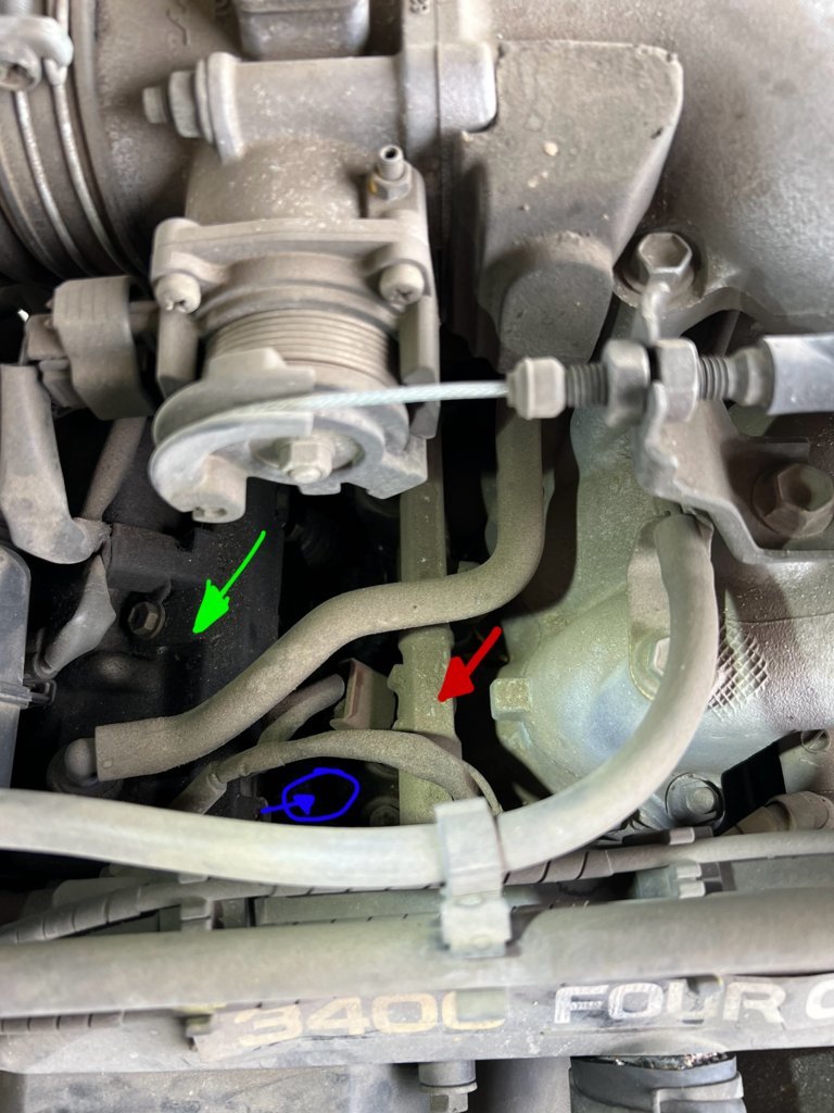

    I got an automotive stethoscope and went listening to different parts. The PS pump, alternator, and tensioner pulley for the AC compressor belt all just sounded like white noise more or less, with the pulley being the loudest.
    I eventually found some parts making a sound similar to the weird engine noise, and through the stethoscope it sounds like a combination of a high pitched jackhammer and a cricket chirping. I don’t know what this part is with the red arrow but that’s where I heard the sound the loudest. I couldn’t really hear it from the valve covers (green arrow), but I could also hear it quietly from what I think is the cylinder head (blue arrow, sorry it’s not lit up in the picture well). It’s also pretty audible from the exhaust right next to the engine.
    I don’t know if the problem would still be the belts or if this is engine knock or something similar. Should I bring this to a shop? I don’t have the experience to do more than minor maintenance and I can’t really risk messing up anything because this is my only car.

    Red arrow is the fuel rail/injectors which its normal to hear a tapping/ticking sound from the injectors pulsations. Chirping sound would be more from a belt. You may also have an exhaust leak.
    Exhaust leaks can sound like valvetrain noise and be mistaken for a tapping valve/lifter in some cases

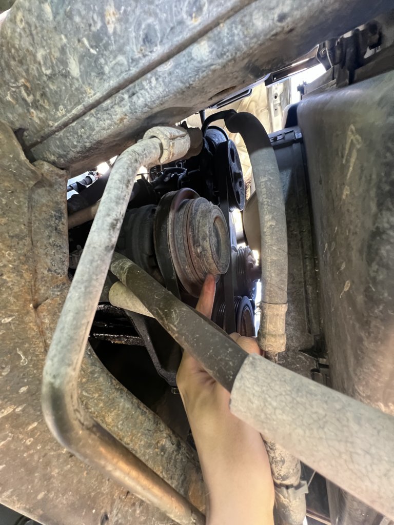

    Working on this some more and I noticed this part of the AC compressor spins sometimes when the car is on, I’m fairly certain this is at least part of the problem. The repair manual I have for this doesn’t label the specific parts of the compressor, so I don’t know what this is/how important it is.
    This is the back of the compressor, Im gonna look it up myself now to see what I can find, but I thought it might help to include.IMG_8470.jpg

    That part is the AC compressor clutch, it engages when the AC is turned on so that the pulley just free spins when the compressor isn't in use. Try looking at with the AC button on vs off and see if it behaves as we'd expect.
