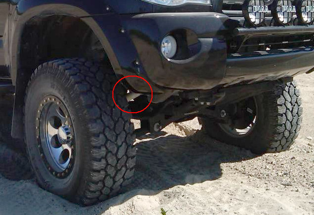

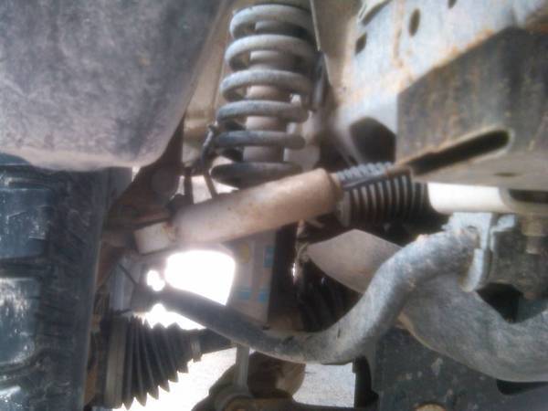

    Is this the shock (red circled)? Very strange... Post a detailed picture when you can.

    If it's running horizontal and connects to the steering, it's a steering stabilizer.

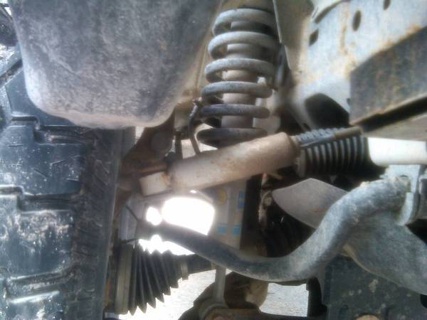

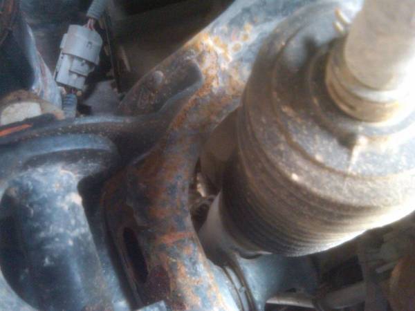

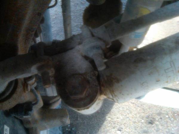

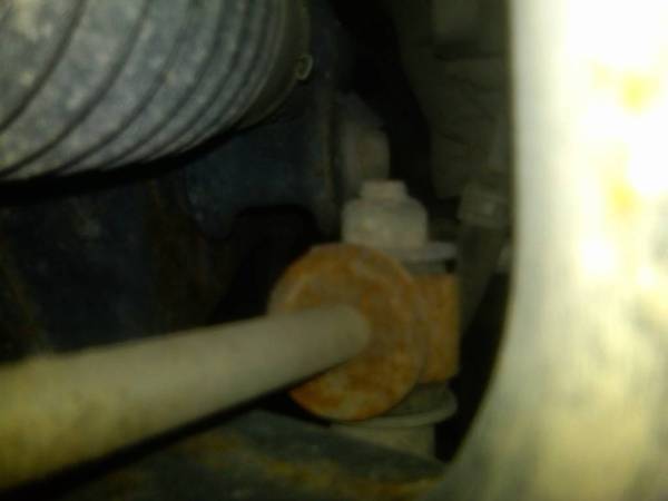

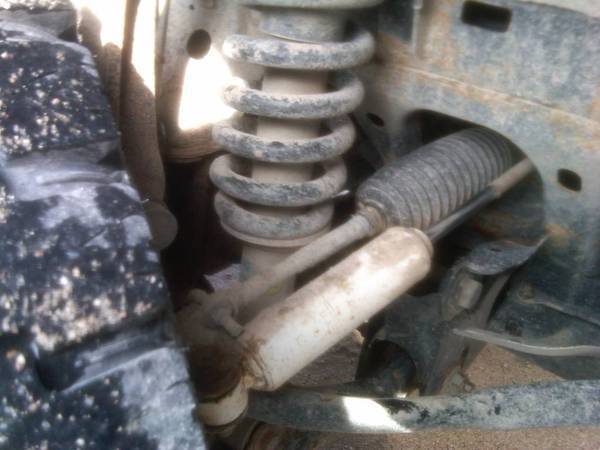

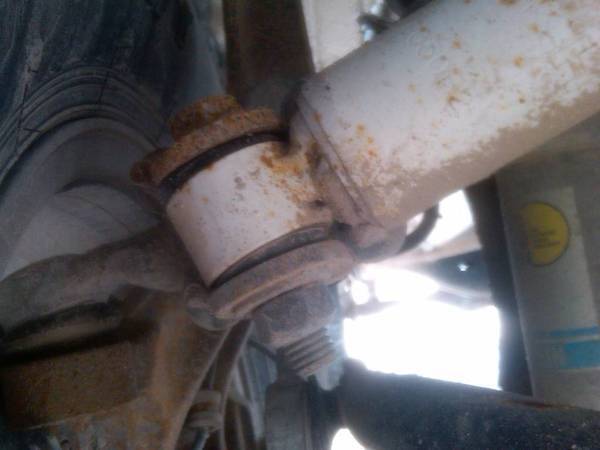

    here are some pictures, sorry about the size. there were two numbers on it. C050B2 and 0E13180 but i cant find those anywhere on fabtechs site. appreciate any help guys.

    That's a steering stabilizer. They are not the same as the rear shocks pictured in the Fabtech kit photo (steering effort would be way too high if that were the case). Don't think it's part of the Fabtech kit; probably an add-on by the previous owner.

    Thanks. Greatly appreciated! Cheers!
